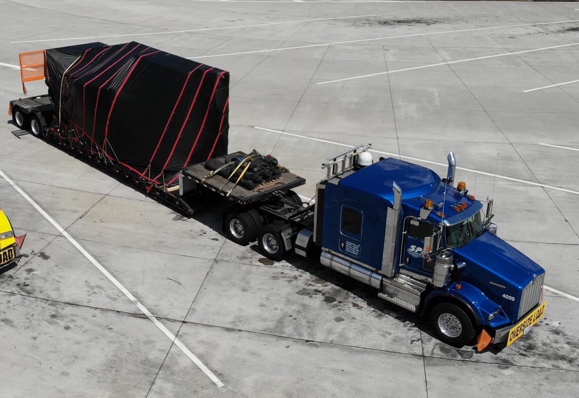

    see that orange piece sticking through the side of that brand spanking new tarp? It was fully wrapped in carpet when it came through the tarp after about 100 miles. Sometimes things just don’t work out. In this case light weight tarps work great for the loads they were bought for. This was not that load.

    Ouch, yeah it be that way sometimes.
    Unfortunate it had to be the lightweights.

    Happens sometimes. Got into a narley cross wind over in Idaho and some pieces ripped thru that still had the duct taped carpet squares around the sharp edges when it came thru the tarp. Learned some new cuss words that day.
    I think u did a great job. That's a tough bazterd to tarp right there.

    Whenever I end up with stuff like that I use rolls of old carpet padding. 6' wide x 15-20' long I've found that it helps to support the tarp over a longer distance and the pads are thick enough that they have some good strength in them. That way the tarp isn't trying to support itself over the long span from the low point on the load to the sharp high point.
