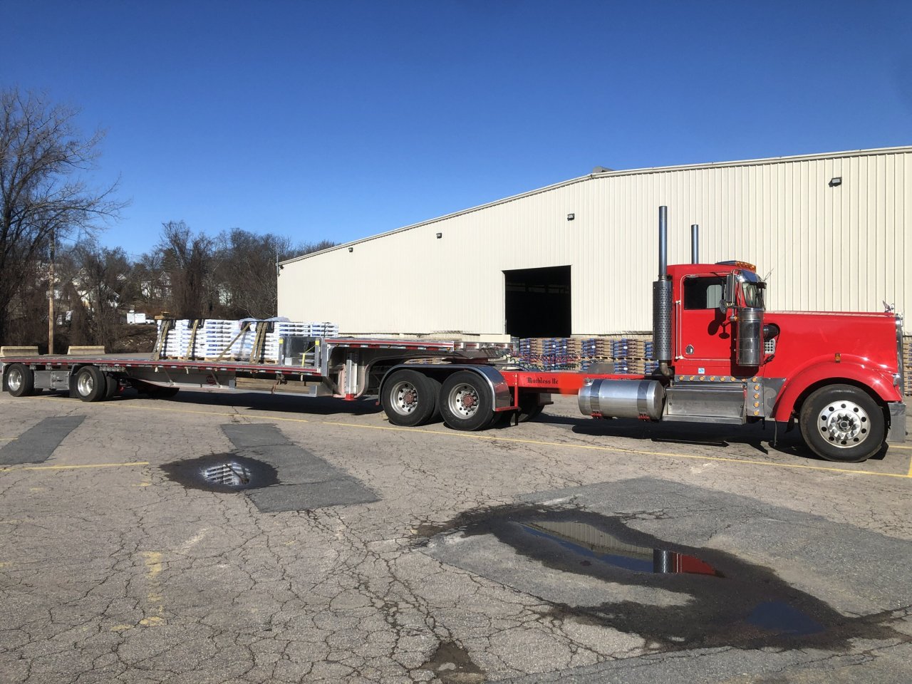

    3:4 loads that been on my trailer this week were shingles
