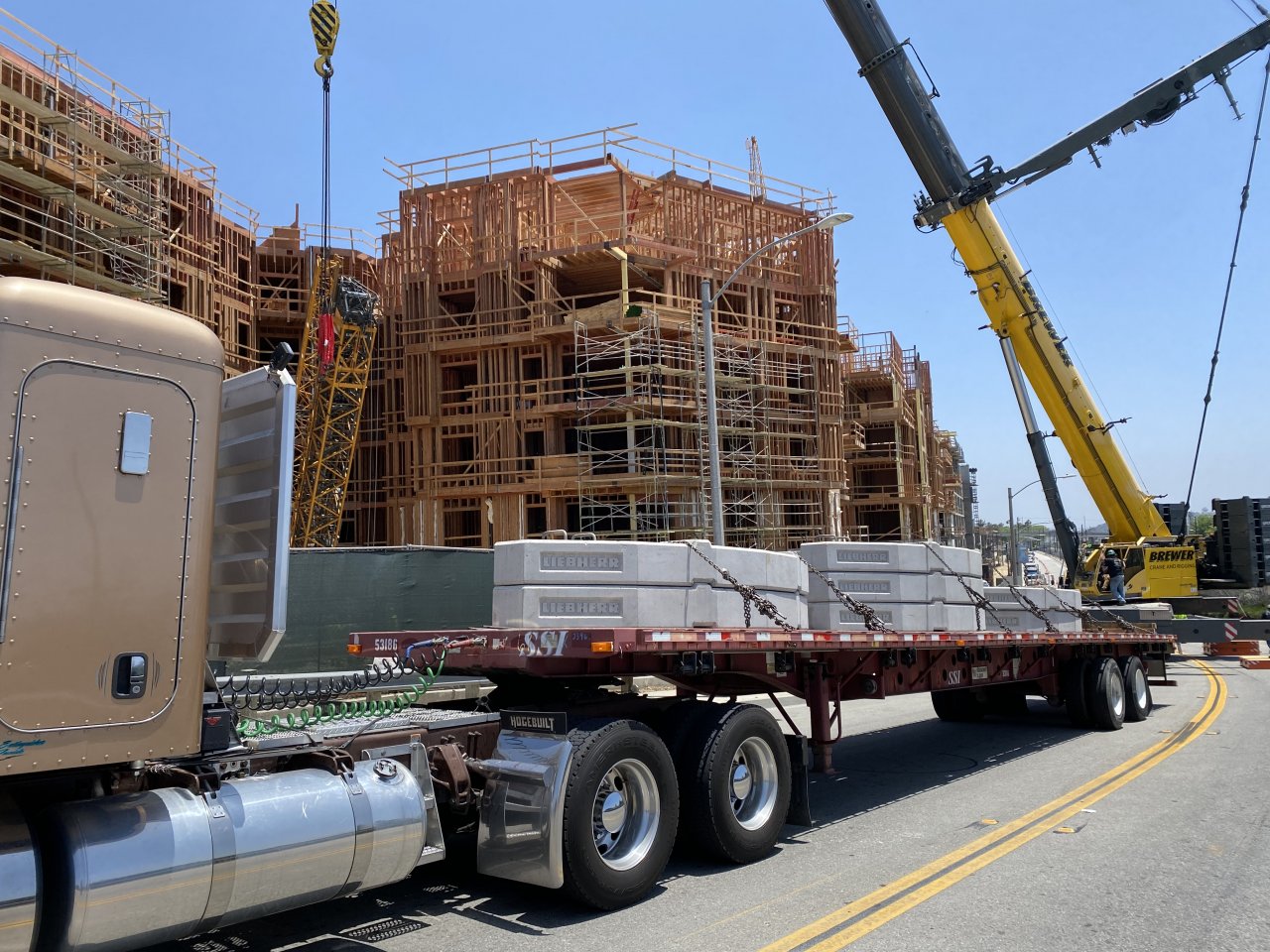

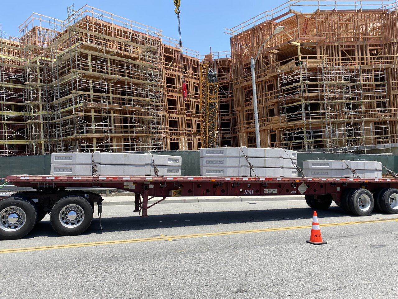

    Saturday gravy run
    beastr123, cke, Kyle G. and 7 others Thank this.

    The problem, of course, is that Booley's load, has the dunnage in front of the strapping, where at the least, to keep in the spirit of that reg, perhaps he should have strapped those two straps forward of the dunnage, or moved the dunnage toward the front of the trailer, considering the over length, engaging the steel sooner within those trailer boundaries and that would have removed some of the possiblity of being gigged.
    Most of the time, the rules are there for guidance, with the exception of the load specific regs, but...even those can be used on similar types of freight that could qualify for that style of securement, and of course, as you point out, the catch all of specialty freight and securement guidelines as is practicable. Which goes back to the point that often, we over secure, to be sure. :)
