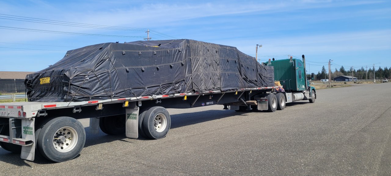

    Thanks something I have found to help is to get those bottom drings and pull them all the same direc tion, right where the tiers go down. Usually I pull those rings forward at the front and backwards in the back . That way the excess tarp will be on the top now and you can yank those upper drings downward and it keeps it all nice and tight.and keeps the wind out of it.
    basically ur trying to keep the lower row of drings running parallel to the rub rail the best u can.. makesit easier to pin down the excess tarp and minimize flapping and everything will stay square.
    This is just the way I've found works best for me. Maybe someone else had better ideas. Hopefully that makes sense

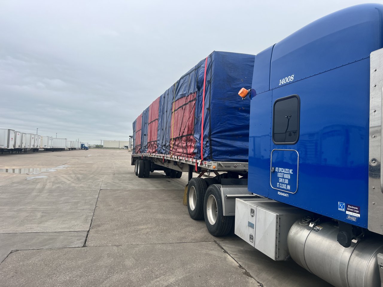

    I'm guessing that's a 53' trailer that you need those 5 tarps for, right?

    Yes. The tarps are: (3) 20x26
    (2) 20x12
    So it's the only way I can cover a load that's 8x8x53. Unless someone has a different idea.

    Don't knock it. I'd have loved to have had that setup, because I never knew what I'd get, and many is the time I wished I had that kind of setup, especially when doing odd shaped stuff, pulled a step and had a larger than normal piece, etc. It's no fun having to try to use two lumber tarps to deal with an oversize.
    I watched the video, that said you guys get 3 tarps 20'x26', and smoke tarps, but I thought they said they were 10 foot, so probably the 12 footers you mention. Figured 3 sideways @ 20' and two end tarps, it had to be a 53', otherwise one of those 3 tarps would have been overlapped by a bit.
