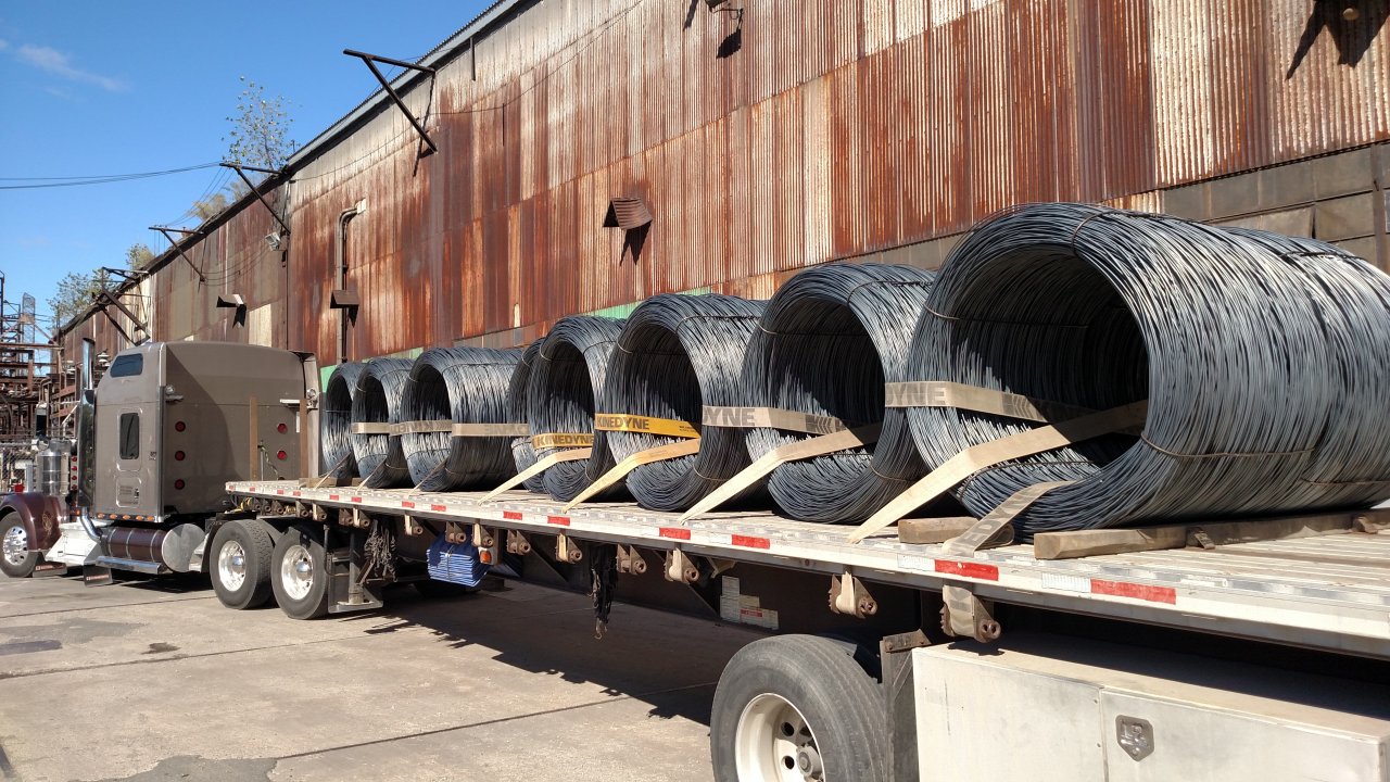

    Couple flat loads from this week, the first are coils embossed then stamped for appliances, the second is a mix load for a retailer. Everything from lumber, trusses, landscape block, cinder block, and beams.
    Sleepy68, skootertrashr6 and MJ1657 Thank this.
