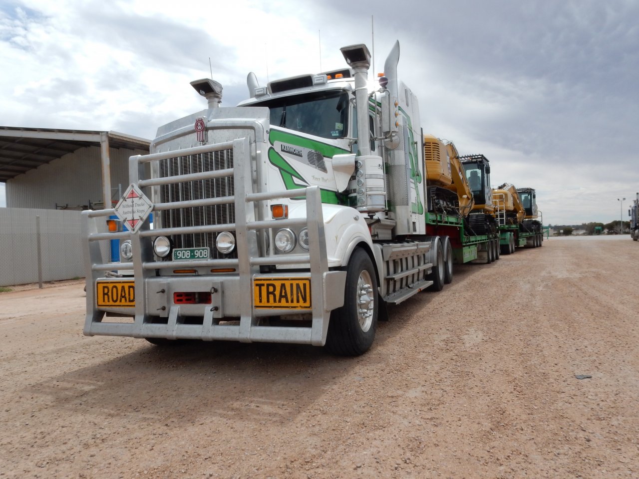

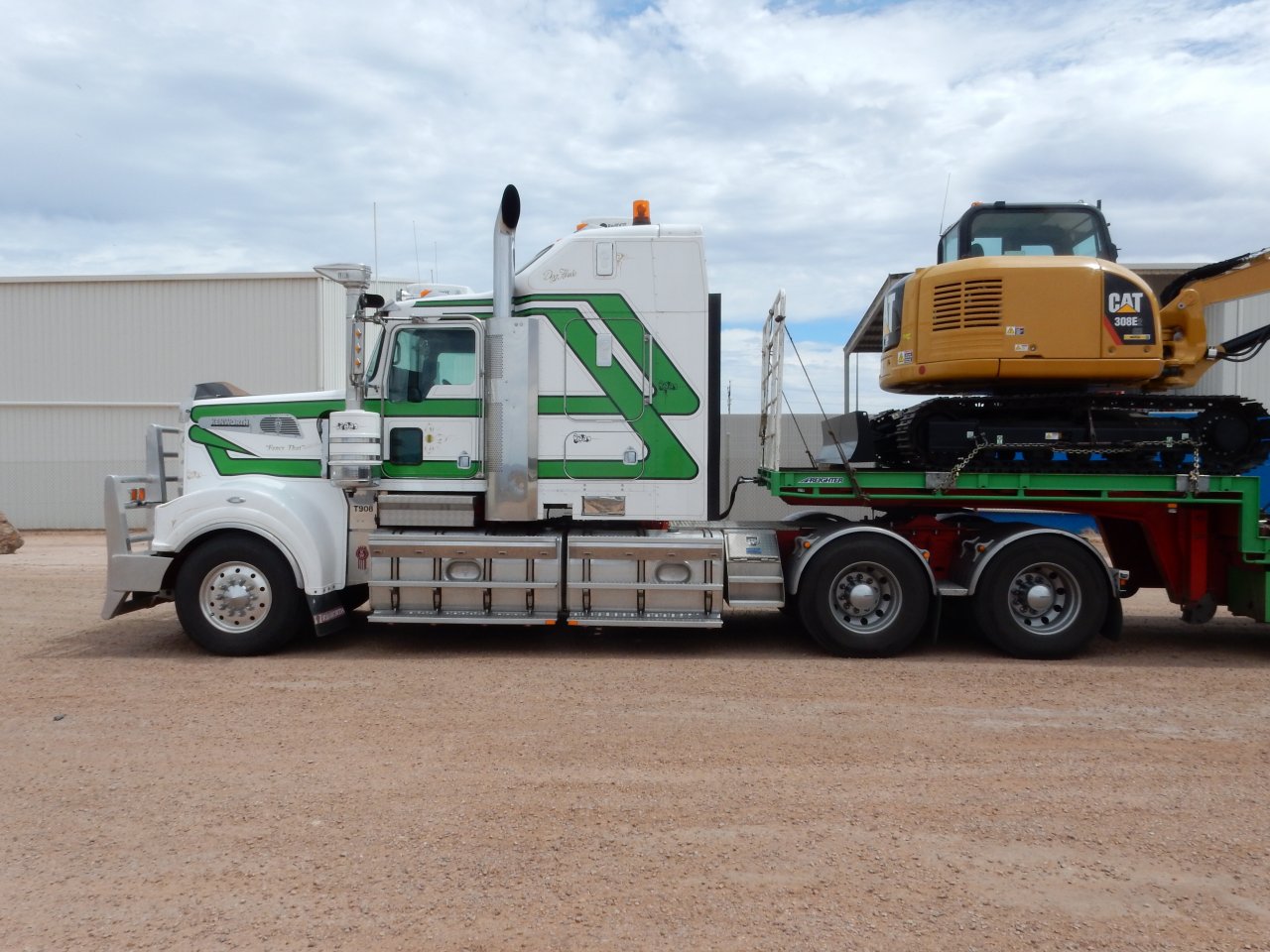

    image.jpeg image.jpeg Cool Kenworth T908 with 2 trailers of CAT machines. Saw this yesterday at Pt Augusta, he was going from Perth to Sydney which is from one side of the country to the other.

  11. johndeere4020
    8,522
    119,296
    Jan 1, 2010
    How far is that?
