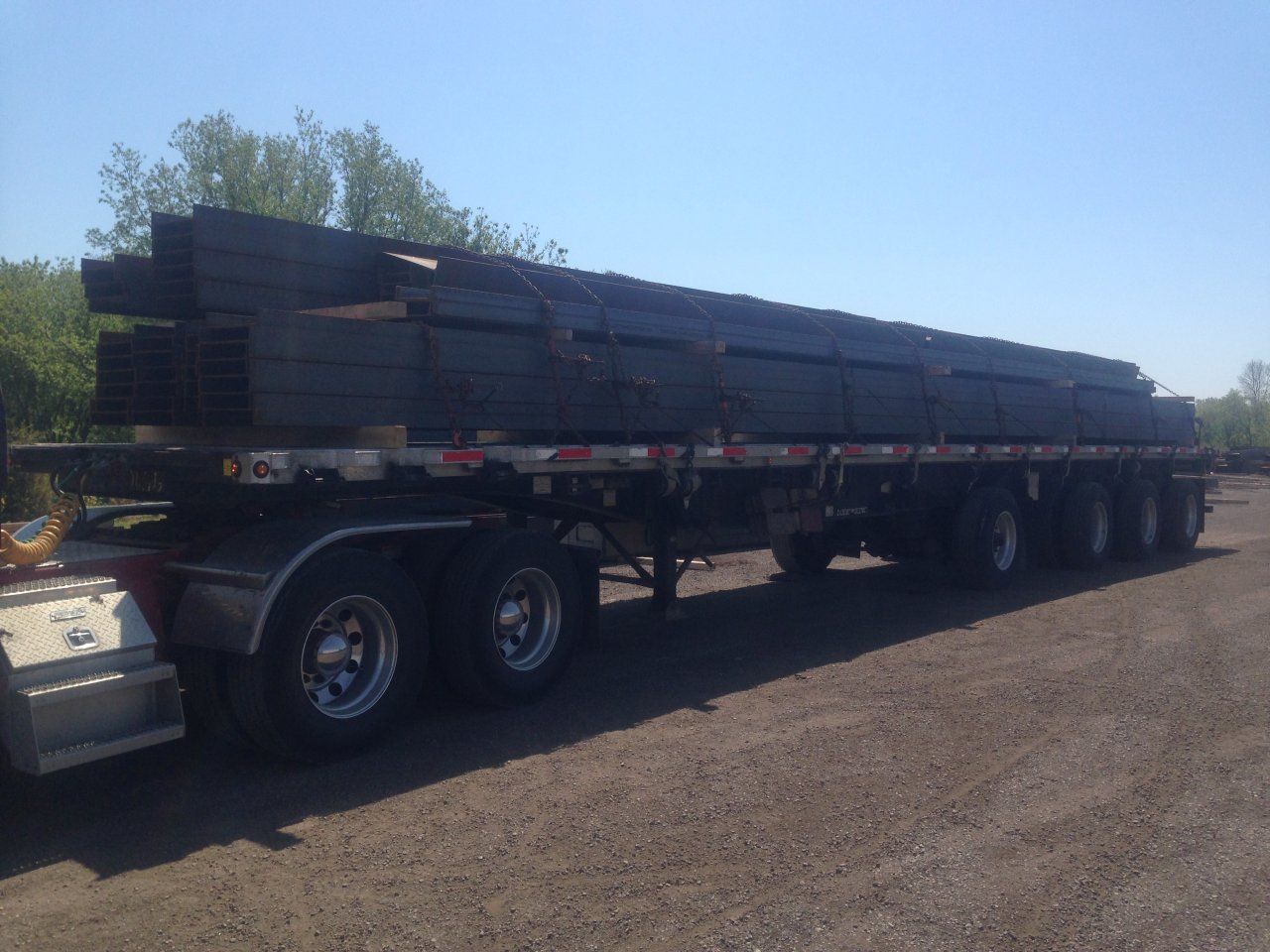

You'll want a "T-block" in between the bundles, front and back (depending on the length, I like them spaced at 10' for anything flexible). It's a 10" 4x4 nailed to a 10" 2x4 on the bottom in the shape of a "T". Set the 2x4 on the deck with the 4x4 sticking up between the bundles. Shipping these kind of steel bundles without tight blocking in between is just asking for trouble.peterbilt_2005, DDlighttruck, Dye Guardian and 1 other person Thank this.
I've not seen them here on the stuff I've hauled but that's a perfect solution.
Maybe alternating binders from side to side would have been a good idea (in theory).Rugerfan Thanks this. -
Thanks!! -
Yes sir. Thanks for the link!Chewy352 Thanks this.
It isn't my solution, but its the one I learned and am glad to pass on. The steel mill here provides them pre-made for all the customers that need "vertical blocking" between bundles for the very purpose of unloading with chains.
