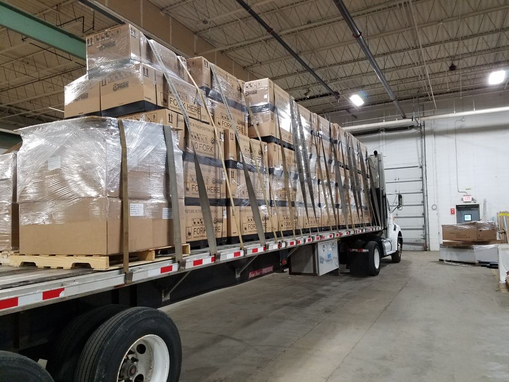

    All right kiddies, here is today's fun,
    115 ac units and accessories
