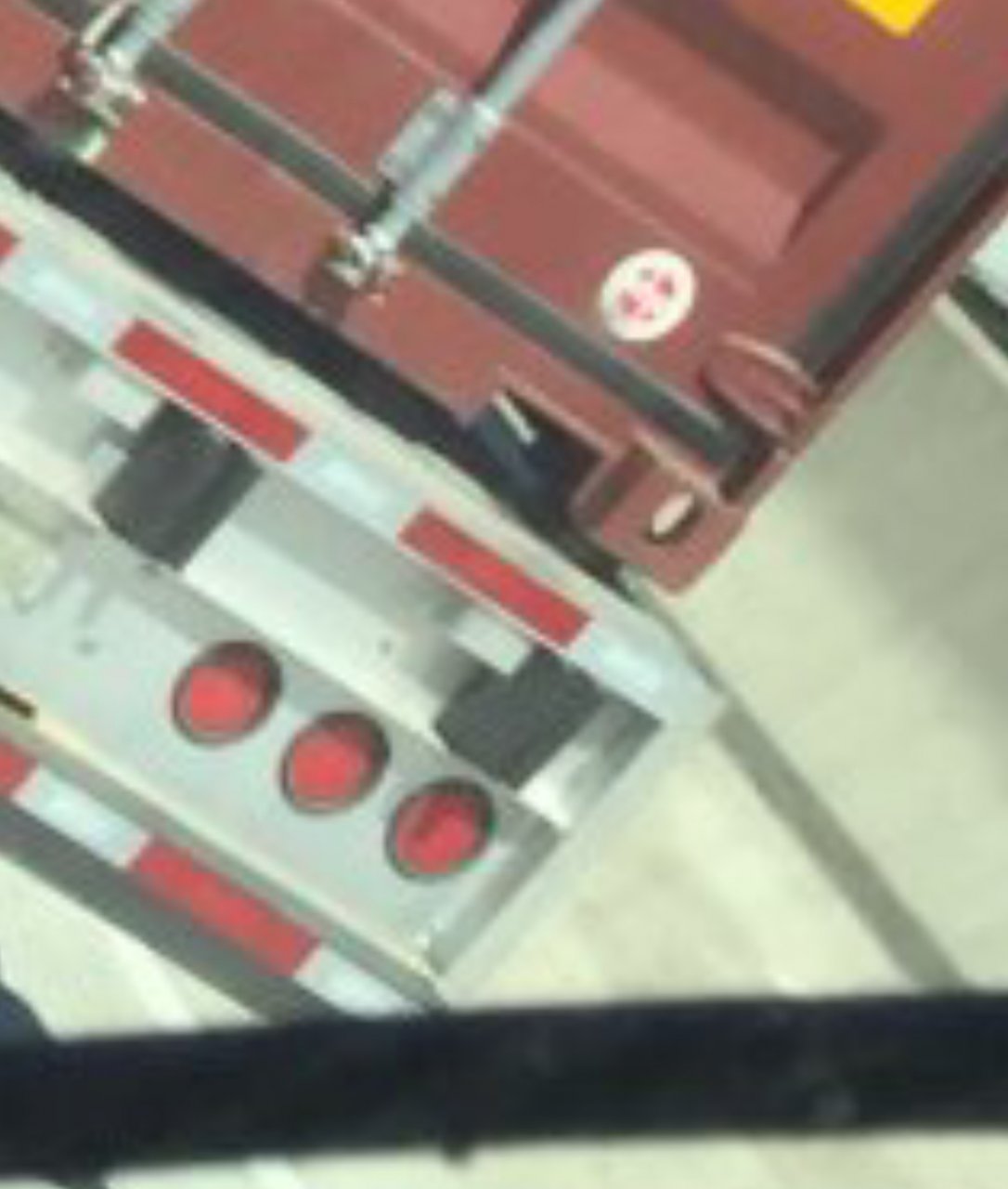

    Look at the rear right corner of the can. You can clearly see that it's sitting on top of a lock.

    if you say so idk if so I wouldn't want to turn them, I don't see a way to do it without putting my hand in harms way unless they turn on the bottom. The ones I seeing were on the side like the ones you linked.
  7. johndeere4020
    8,522
    119,296
    Jan 1, 2010
    There's a lever underneath the trailer they're perfectly safe.

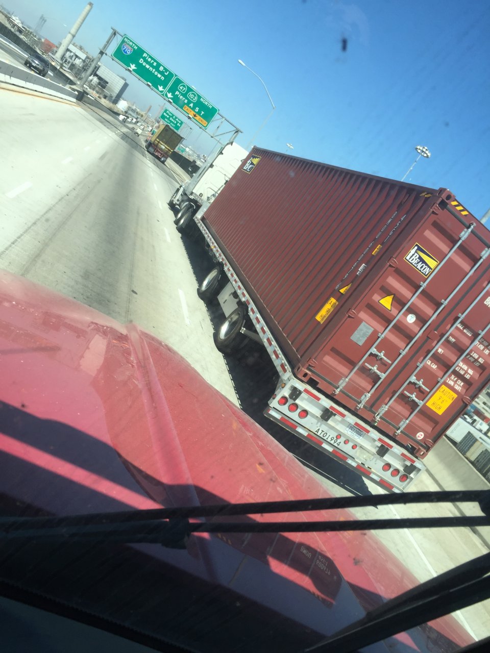

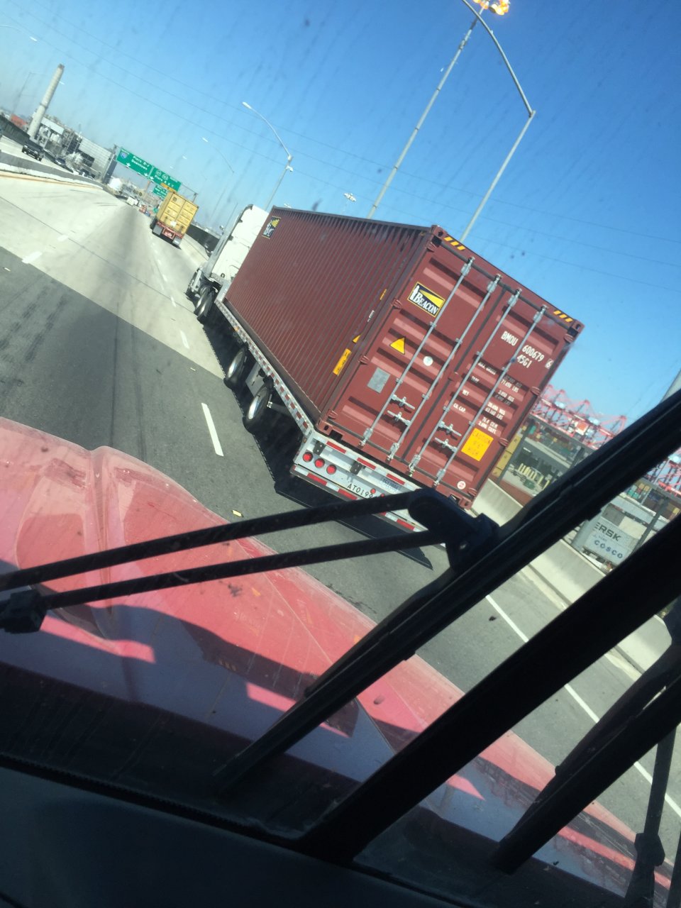

    you know, now I am going to have to hunt this guy down on Saturday's stock him in the line and take a photo of bed empty.... I am truly curious
  9. MACK E-6
    50,462
    242,823
    Somehow, I think not...
    ETA: Yup. That guy did dodge one hell of a bullet.

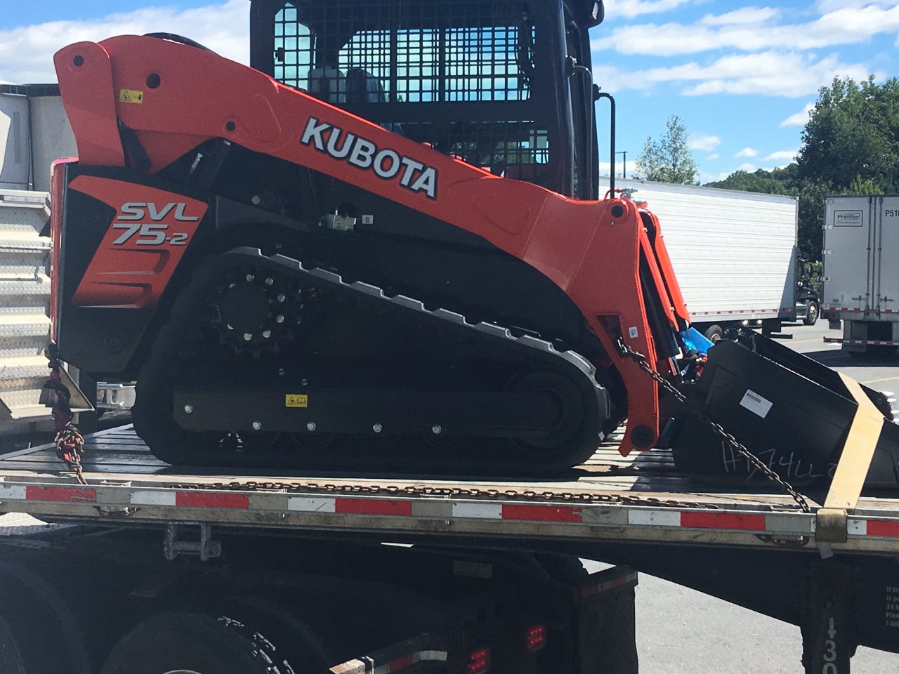

    That is a case of epic fail. It doesn't take a physics degree to know that when all securement pulls in the same direction, it doesn't hold diddly squat.
    Amazing...:rolleyes:
  11. Cheap Weenie
    Cheap Weenie Light Load Member
    152
    148
    Oct 8, 2010
    And johndeere4020 pointed out something I missed...there's only one binder on that side. He's got one continuous chain for both ends of the machine!
