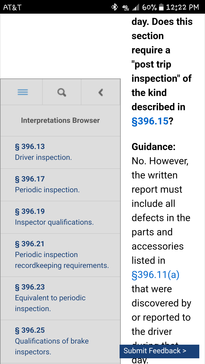

  7. jammer910Z
    jammer910Z Road Train Member
    2,446
    6,522
    May 28, 2015
    Screenshot_20180129-122212.png @DSK333 ... thanks for bringing this issue to a cricket chirping close!

    No clearly you did not read your own reference:
    "§392.7 Equipment, inspection and use.
    (a) No commercial motor vehicle shall be driven unless the driver is satisfied......"
    Nor did you read my prior post where I pointed that out. Nor is their any guidance on that section stating a pre-trip inspection is required.
    "Question 25: Section 396.11 requires the driver, at the completion of each day’s work, to prepare a written report on each vehicle operated that day. Does this section require a "post trip inspection" of the kind described in §396.15?
    Guidance: No. However, the written report must include all defects in the parts and accessories listed in §396.11(a) that were discovered by or reported to the driver during that day."
    396.11 is clause governing the post trip inspection and report for normal trucking operations. Read the title:
    "Section § 396.11: Driver vehicle inspection report(s)...."
    How do you do an inspection report without an inspection? Clearly an inspection is required. What is no longer required is the need to submit the report if no defects are found.
    396.15 is the clause governing only driveaway-towaway operations only. So no a regular trucking operation does not have to inspect the tow-bar and the saddle mounts like described int 396.15. It would make no sense to inspect a tow-bar or saddle mount you don't have. OK?
    Your mis-reading is just injecting wrong information into the situation.
