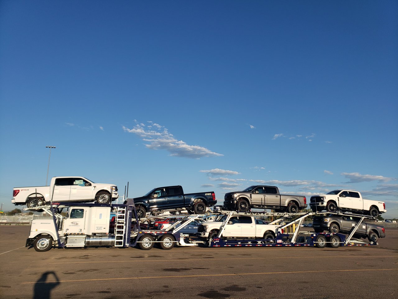

    Just a typical out west load. 4 Diesels, 2 150's, ~84k

    I ain’t never had a pickup on the roof and been able to see!!!:D Look at this guy putting in tall work!
