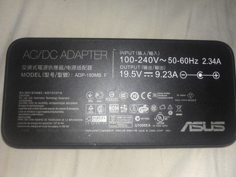

  7. BigMuthaTrucka
    BigMuthaTrucka Light Load Member
    167
    79
    Mar 28, 2012
    West Valley City, Utah
    ^^^that's what the power box says for my asus laptop
  8. ironpony
    ironpony Road Train Member
    17,502
    12,015
    Sep 23, 2007
    Ask my GPS...
    OK... so your inverter output is going to be in the 110 to 120VAC range. Let's say it's 120VAC...
    120VAC * 2.34A = 280.8W
    Add up the power (the ratings in Watts) you need for everything else you're going to run at the same time, and you have the total load power in watts. That doesn't include start-up surges, and some extra for when your batteries start running down. A 300W inverter will barely be able to handle your laptop when it's using all of that 280W. It may not be using that all the time, but it might be at startup. It's better to choose something with more available output so you don't run into trouble.
