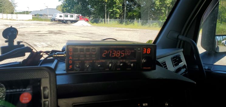

    Cascadia is easy as far as power is concerned. Mount radio on dash using stock radio mount and HD Velcro.
    Different radio, same size.

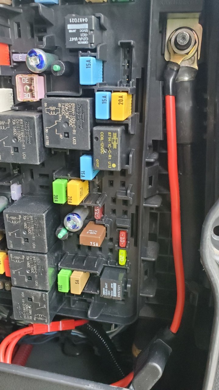

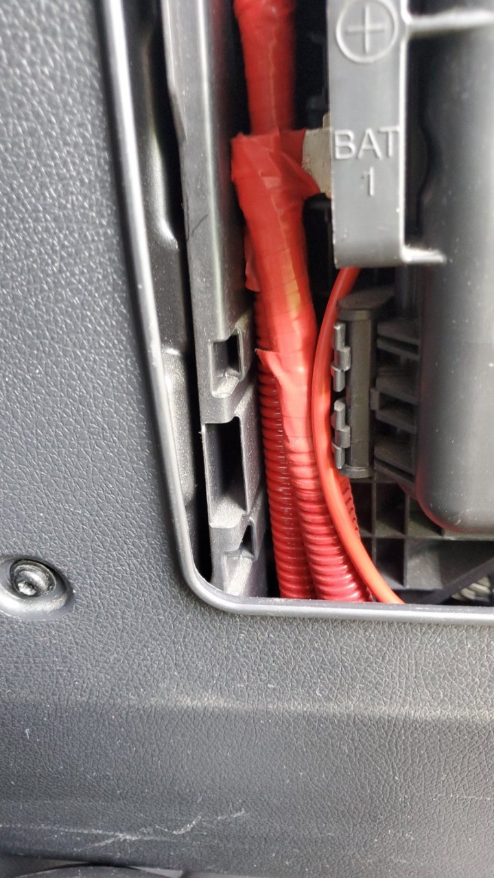

    Next, pull passenger side dash panel off to get to breaker panel. Hook power wires with proper ends and fuses to battery feeds on breaker panel.
    This is much easier than trying to run power direct from the batteries, especially if your truck has the batteries mounted between the frame rails behind the cab like the truck I had.

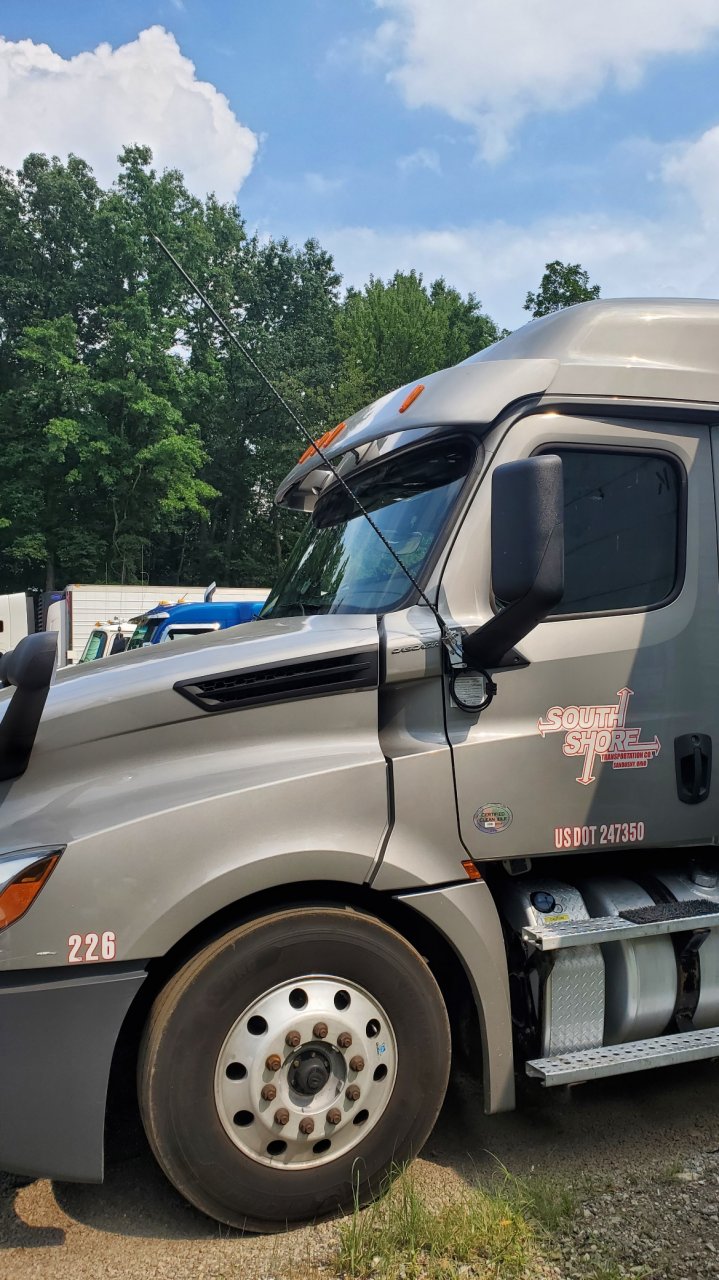

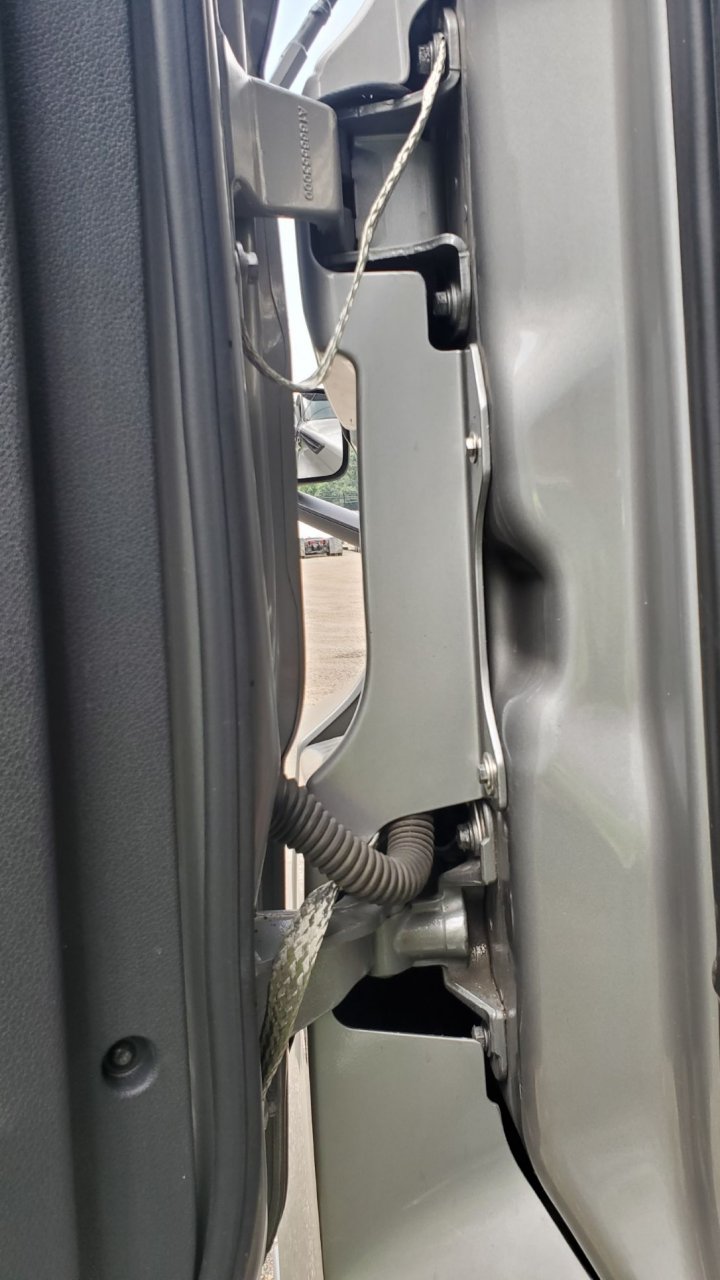

    The antenna system will take some care getting something decent. Freightliner Cascadia body panels are made of aluminum (not plastic, dummies!) and are bonded, not welded together. It makes getting a good RF ground a little more challenging! Ground doors to cab and cab to frame. Cab to frame is easily done by running a ground strap from top to bottom bolts of rear cab shocks.
    These ground straps work well along with some star lock washers to bite into the paint.
    https://www.amazon.com/gp/product/B000C7WSMY/ref=ppx_yo_dt_b_asin_title_o05_s00?ie=UTF8&psc=1
    This is how I mounted the antenna......
    The antenna mount is readily available at many truck stops. The antenna is a 6 foot Skipshooter. I never ran a piece of PVC on the bottom and it held up well. They will get real wild if you run into freezing rain a lot. Not found in most truckstops but Walcott does carry them.

    This is exactly what I needed, what gauge wire did you use and is your line fused? Where can I find a electrical line like this?

    I used 10AWG. I got most of the stuff from Amazon......
    Wire-
    https://www.amazon.com/gp/product/B0796JJHTQ/ref=ppx_yo_dt_b_asin_title_o03_s00?ie=UTF8&th=1
    Fuse holders (I fused positive and negative)
    https://www.amazon.com/gp/product/B07G7YMJXW/ref=ppx_yo_dt_b_asin_title_o03_s00?ie=UTF8&psc=1
    Most of this can probably be found in a HD/Lowes anywhere.
    I did use Anderson Power Connectors to a junction block on the dash to facilitate quick change of radios seeing as I have about 4 or 5 radios that I will swap out from time to time and I will use a West Mountain powered DSP speaker with radios other than the 5555NII. This is,of course,not necessary.
