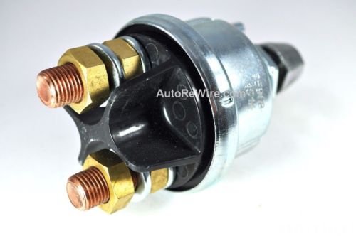

    no but i did take them to auto zone today. they put them on a trickle charger for around 3 hours. 2 took a charge and the other 2 were still dead so i will be going to kenworth to get them replaced. im trying to find a aftermarket disconnect switch but can't seem to find one that looks like it would work well. tried ebay and amazon so far. the picture below is one that says will work with kenworth mac etc but it just doesn't look like it would work well from what i can tell. seems like they should have a better design then that bolt deal to hold the cables. this ones 45 bucks..

    As long as it's rated for 200 amps, it'll work.

    I just realized that those battery cables have a loop on the end so it would work fine. i guess ill have to get a short cable and crimp some loops on it to run from the disconnect to the batterys though or just buy one from kenworth.
