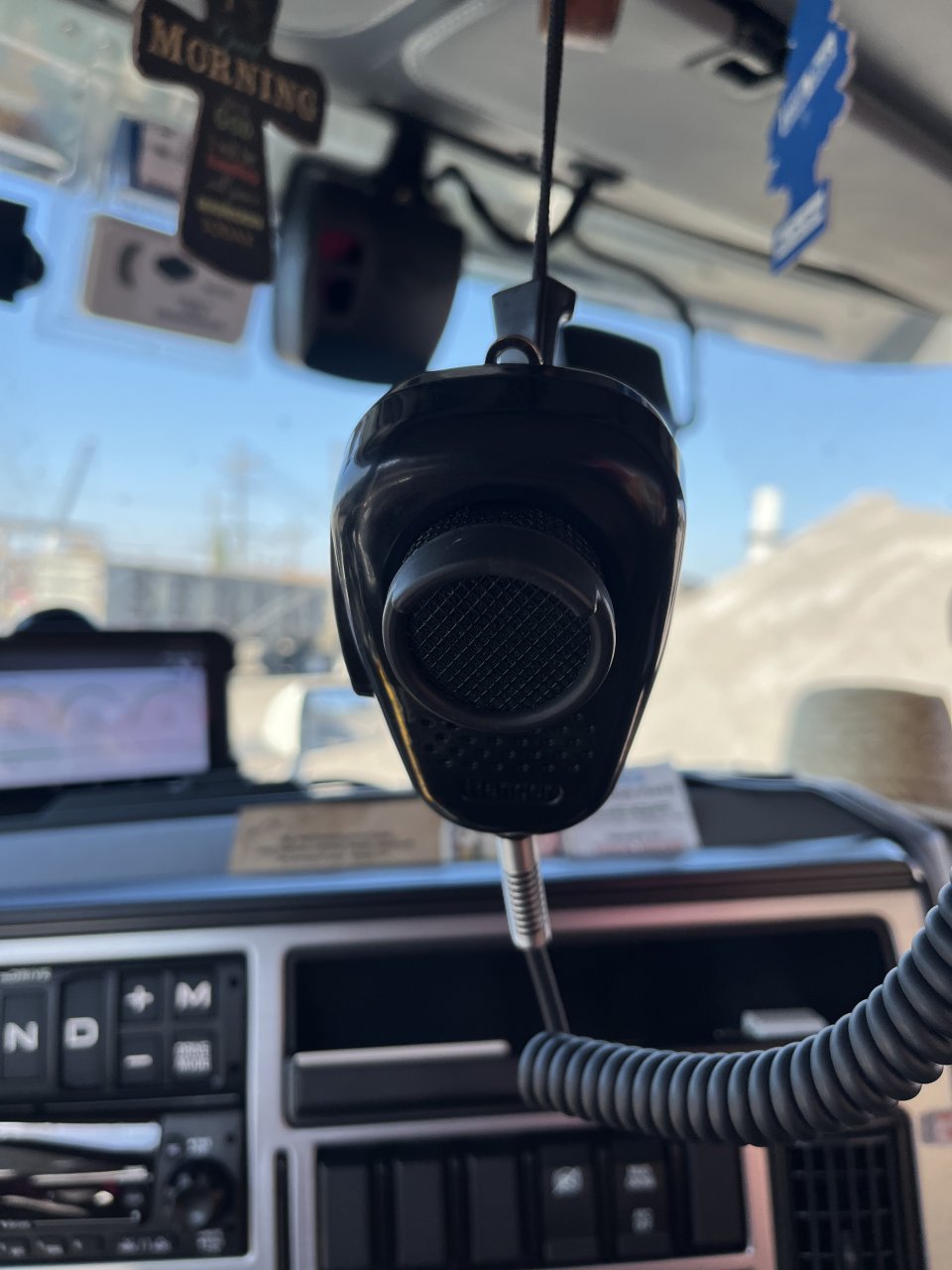

  11. Trashtrucker1707
    Trashtrucker1707 Road Train Member
    1,792
    5,239
    Dec 30, 2017
    I think you have this preconceived notion that money buys power, not really what I’ve experienced. I was like you and at times and spent excessive money to “talk” and only ended up wasting that money. Listen to the advice you’re getting and find a reputable tech like I did that will show you the proper set up. From what I’ve seen the big radio that you hear in New Mexico, the same as I do in Florida, isn’t even a base station, it’s as he describes a finely tuned set up. My 29, with a good coax, a 40$ dollar ranger mic, and less than 50$ antenna is the best set up I’ve had in 20 years. The service to the radio, the mic the coax and the antenna were all available at the shop in baldwin Florida I referenced previously. 60EF1E21-2600-4931-B788-6BC59E2E973F.png 5A695EF7-C5CE-4016-83EB-C985B45BD427.jpeg
