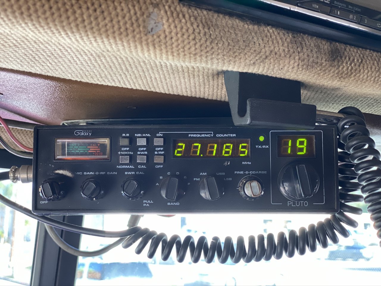

    What kind of range you getting with it? Does it get stepped on pretty easy?

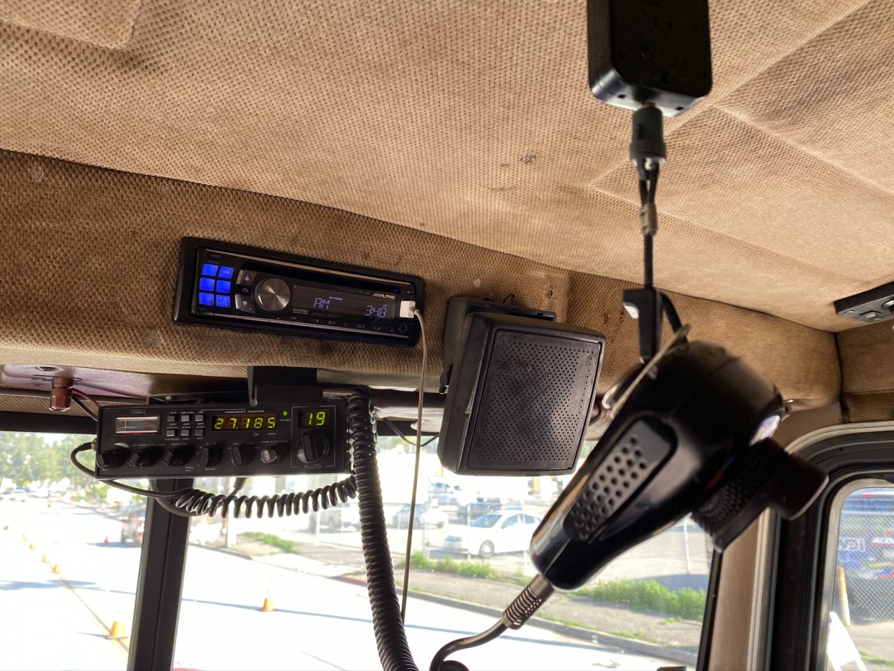

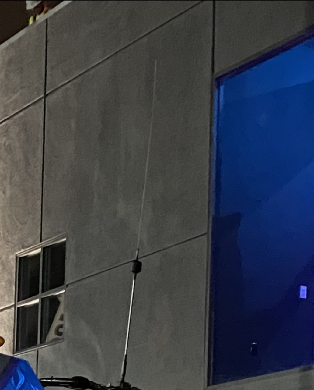

    Anyone that keys up that is next to you, your gonna get “step” on. What you want is a clear sounding radio. A good mic like a SRA 198(my preference) and/or the old “Telex/Turner 56 will do the job. Now everyone that’s posted are making a valid point about the antenna, there’s then just getting your SWR done below 1.5, you need a good ground plane and like mentioned also already, a good coax, not those factory coax built in. But you keep going back to, that you already have your antenna set up working correctly and your hooked on getting a bigger radio, those 29’s are good radios, instead of spending on export radio, purchase and linear(amplifier) instead. Make sure you wire it straight to the batteries(with a fuse). Make sure the radio is stock and not butchered. I myself am happy with my set up. I get compliments all the time on how clear it sounds. So back to your question, oh wait, I already answered it in the beginning.

    10-4 thank you.
    I am unsure how to test for ground plane but I'll look into it!
    The linear amplifier I can work with. Do you know any good resources I can use to research them. I intend to use google but I'm new to radio tech.
    The coax I got from a cb shop tho I probably should have went with a bit longer because I don't have much slack.
    My mount I'm currently using is the only one that would ground the antenna at all, the two ones I bought from the loves/pilot sucked I never could get a good swr.

    If your goal is to communicate with trucks in your vicinity as opposed to long-distance skip, not very many trucks (I don't think) are driving around with 1000w linear amps. If it takes that much power for them to hear you, how are you ever going to hear their little 4-watt signals in return? Your range will far outpace theirs.

    With the right person listening there's no reason you shouldn't be able to reach out 40 miles under certain conditions with that Cobra 29 and 5 ft antenna. Naturally most people aren't going to be able to hear you from that far away but there will always be a few people capable of hearing you from three or four times further than most everyone else.

    One of the best antennas you'll find is the 29 dollar "coil" style antenna that replicates a 102" whip. Put one of those on each side of your cab WITH A GOOD GROUND and you'll be able to pick up radio free Europe.
    CB antennas are like sex, you want the most inches you can get and there is no substitute for altitude. (Think the mile high club) A 5ft antenna on a mirror mount won't hold snot to a rubber duckie hand held from a guy standing up on top of a cell tower. So get it as high as you can. And as long as you can.
