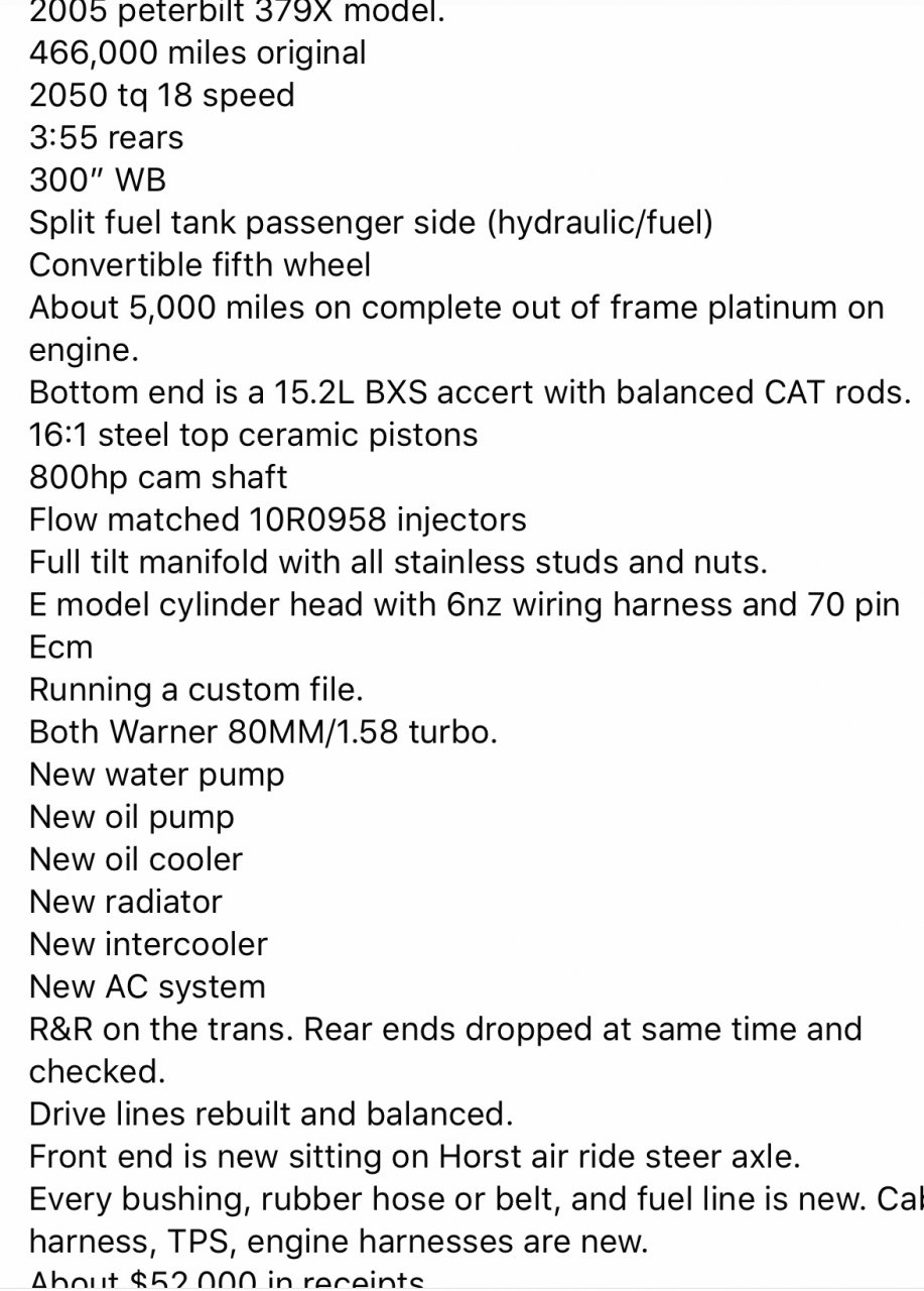

    The seller has the vin # stating its a 99 motor. But then again he has a lot of going on in that motor. But #### in really liked this truck but if its not eld exempted then I’ll stay away.

    Also he did mention crank block head is bxs15.2 lt ecm harnesses are 70 pin e model.
    And in another post he said “this engine is basically 6nz just has the 15.2 block crank with c18 parts in it.
