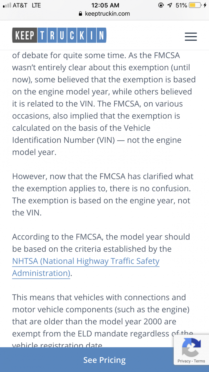

  10. Black389
    Black389 Light Load Member
    181
    42
    Dec 1, 2016
    Indy
    This pic says eld exemption is by serial # on motor not by vin? 85D30C6F-4BE0-45BA-9AE0-723E9FC8D98A.png

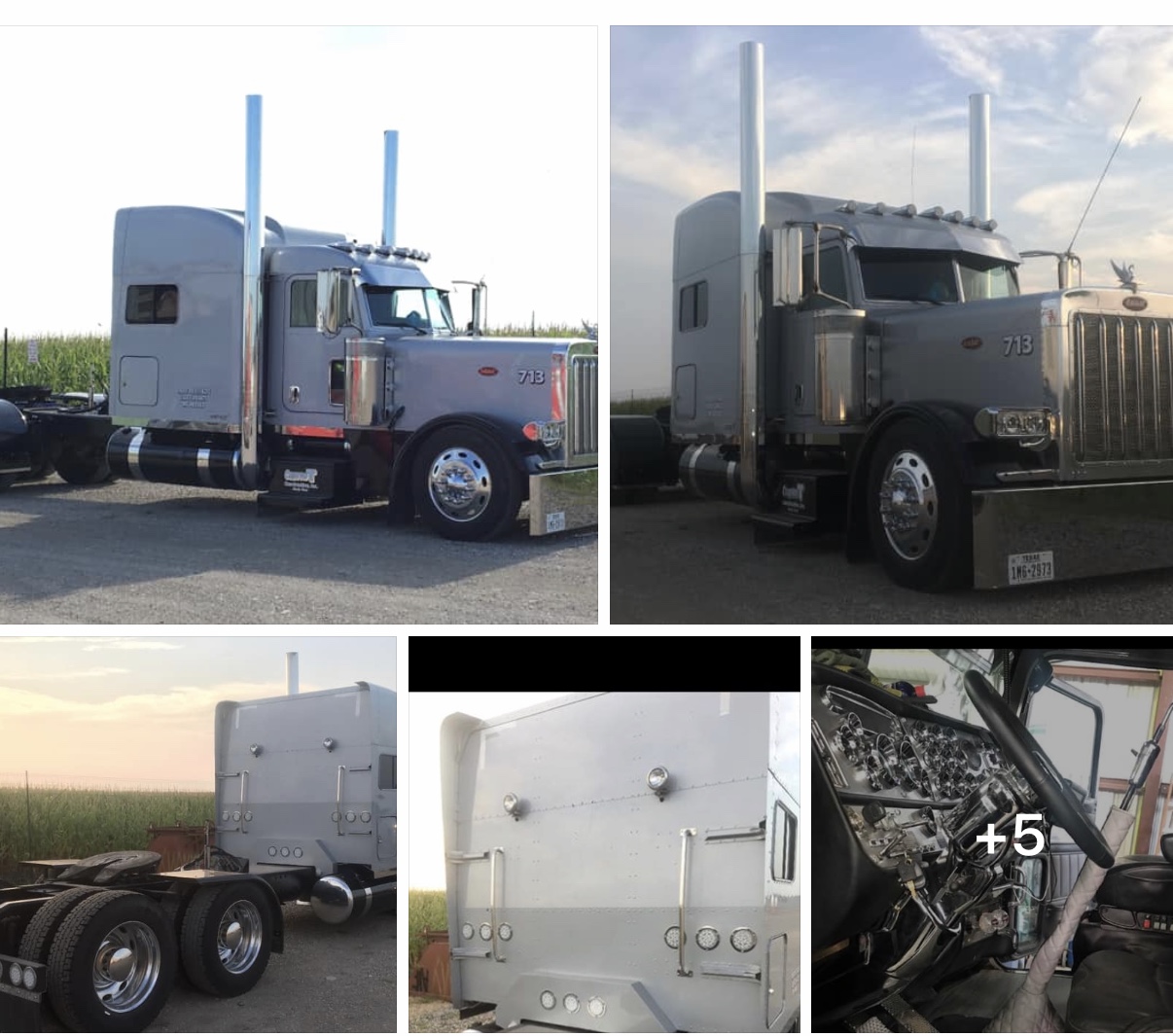

  11. Black389
    181
    42
    Dec 1, 2016
    Indy
    Yeah i’ll definitely have a shop check it out before getting it. Truck is really clean. Almost a show truck. But i will have it inspected before buying it. 7B61EBE6-3003-4B33-9263-BD4620A71BF8.jpeg
