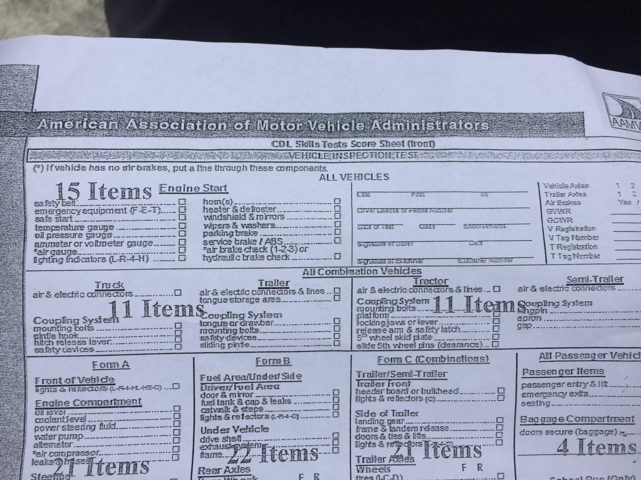

    Pre-Trip is not as hard as it seems at first. In fact, it is the easiest part of the test. Just look at the tractor/trailer, remember the parts. Check the images below and find those parts on the CV and memorize them.. you will pass with flying colors. (This is the actual format used by DPS here in Texas. Your's would be somewhat similar too.)
    btbolin and manny0523 Thank this.

    This is a good video but it has too much information.. you don't need to explain that much in the actual test. Just look at the images I attached above and get the most you can from this video and you are all set for the pre-trip.
    manny0523 Thanks this.
