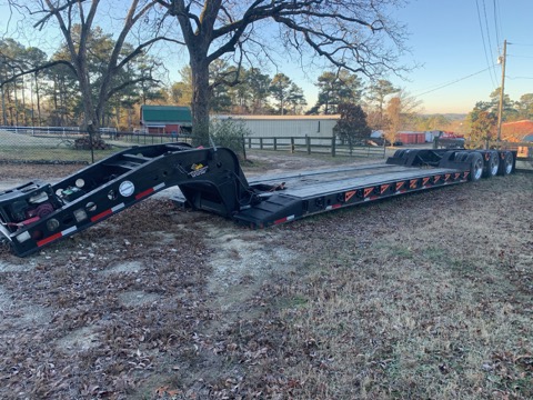

    well guys, i think ive finally locked into my new(to me) first trailer.
    99 Fontaine 50T, owned by an older gentleman locally. He used it for his Grading/Paving business and decided he was getting old and traded it for a traveling axle Talbert(?)
    new tires, new brakes, and it looks really good( in my completely newb opinion)
    ill include the specs Fontaine sent me.
    i decided to go with a cheaper first trailer so i can start out smaller and then spec a new trailer in a year or two to my liking. what do you guys think?

    Nice looking trailer....how many feet in the well?

    24ft, so not the ideal 26, but should get me by for the majority of things... i hope

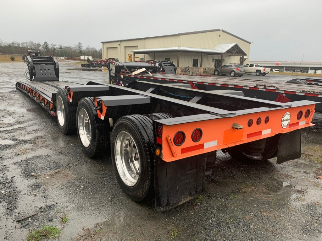

    Update, they are getting the figures together for me on replacing the electrical, suspension, and rebuilding the hydraulics. And another trailer caught my eye.
    It's a 2008 TK70, hydraulic neck, triaxle, with a 28ft well, but its gonna be about 12k more than this Fontaine.
    My question for you guys is how import is 4ft in the well?
    I like the fact that the TK is 9 years newer, and has a 28ft well. I know the Fontaine has been well cared for and probably sat more than it was used. I am concerned with running the TK at or over capacity often, as I'd like to always be overly cautious.
    From what I can tell on the loadboard, about 60% of the RGN loads are under 24ft. With another 30% being in the 24-28ft range. The last 10% needing extendable decks.
    Not worried too much about excavators, dozers, and vehicles as many will allow me to set the overhanging pieces on the rear bogie. But would I be better having the deck space or the weight capacity/less abused trailer?

    As far as the question how important is the extra 4ft..... Thats hard to answer. If you base it on the board and they have stuff listed as 27ft or 22ft or even 35ft, sometimes it can be a vehicle and a smaller well will suffice but a lot of brokers just see the foot amount and assume you need that much in the well. Ive got 29'6 in the well and I can't tell you how many times ive been told one measurement and its totally different. However, as you do this more and more and learn the machinery, you'll learn the dimensions and weight and what is needed in the well.
    I would think you're giving up well space in order to carry more weight with a shorter well. So I guess the question would be do you want to do more weight or have more capacity in the well?

    That's my take as well. That's what I'm trying to decide, what is more important 50T @ 24ft or 35T @ 28ft
