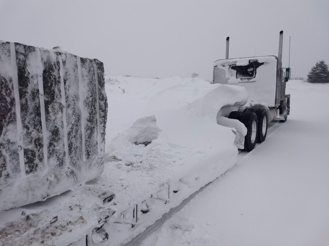

    Minnesota. The white stuff got imported from Northern Ontario.
    The border agent had to run his geiger counter around the truck to make sure I wasn't smuggling radioactive material with the rock. (Granite from that region gives off isotopes and red flags their sensors).
    He come back in the building laughing saying I could very well be smuggling contraband but he wasn't going to shovel to find out.

    Hahhahahaha... that's awesome. Didnt the snow add a couple tons to the weight?
