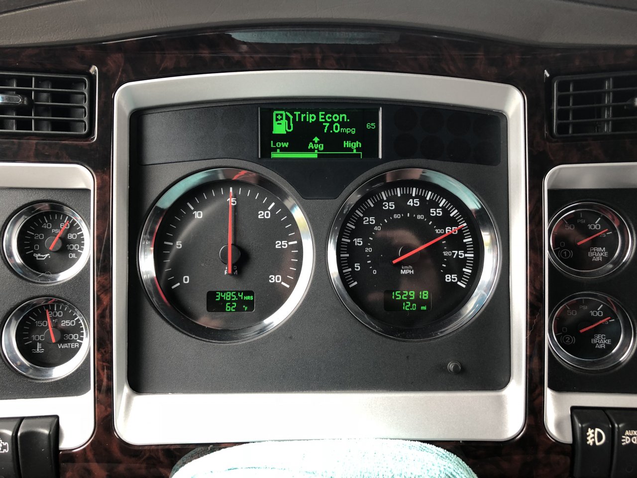

    Look at the trip meter, I was only 12 miles into that tank of fuel. Lol.

    I like that. That truck gauges tell me shes doing well with potential to deal with the little hills around the area there.

    As a parting shot, I love the gauge picture, it's good and tasteful. But would imagine those silver rings would be a problem when the sun comes in off the drivers window sometimes. (Ive always had trouble with that, it's just one of those life time things when the eyes burn in dots from concentrated sun.)
