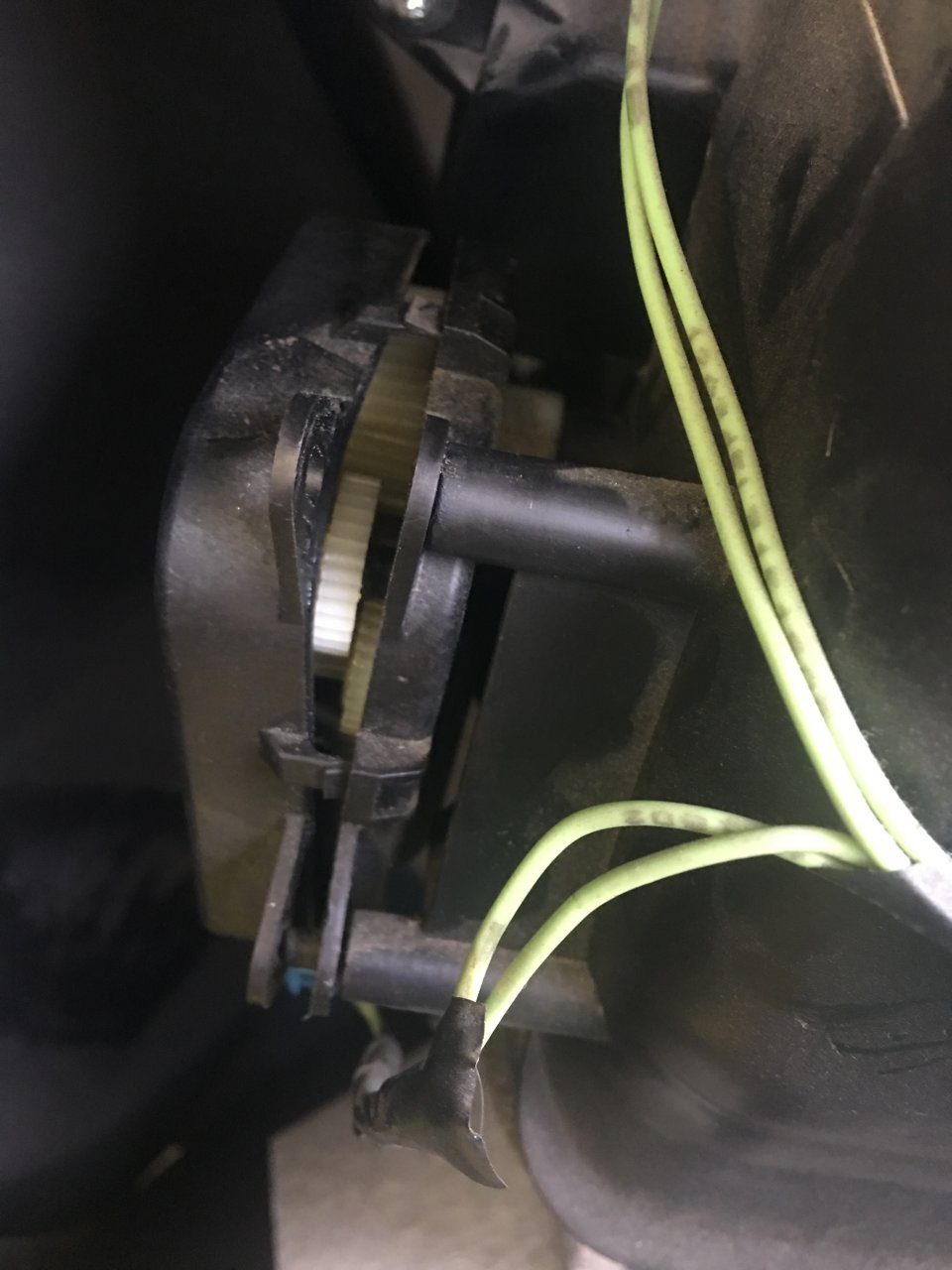

    I found my actuator none of the gears are spinning when I change the knob.. is it a bad actuator or the climate control box.

    The actuator is located near firewall right? So when I turn the controls that spins around stops then if I change controls again it doesnt spin anymore

    Yep, that actuator is split open. Probably a broken tang. They are held in with 2 or 3 torx head screws and come straight out.
