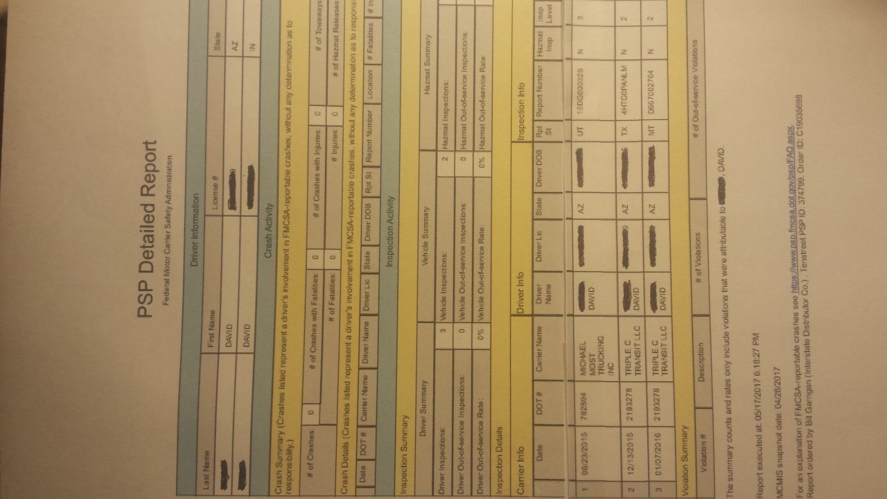

    ANYWAY--- I got an actual copy of my PSP report, and when I get it all blacked out, I'll post it.
    What does it contain???
    1) Lists CDL's you've had from the time you got your first one.
    2) # of Crashes. Broken into subspecies-
    a) Crashes with fatalities
    a1) Number of fatalities
    b) Crashes with injuries
    b1) Number of injuries
    c) # of towaways
    d) # of hazmat release
    3) Inspections-
    a) Driver inspections, how many out of service for driver, OoS rate ( % )
    b) Vehicle inspections, how many out of service for vehicle, OoS rate ( % )
    c) Hazmat inspections, how many out of service for hazmat, OoS ( % )
    4) Then it lists your inspections, now mine only goes back two years, cause I was doing mixer for 3 years, so the years before that, I guess they weren't keeping score or track.
    The inspection part contains all your inspection report numbers, date, location, and carrier.
    No where does it list points. It has columns for violations, but nothing that say points. Of course I'm a good boy and don't have any and never cheat :rolleyes:, so there's that.
    So anyway I'll scratch out my license numbers and scan it so everyone can see one. They send you copies of all this stuff.

    I like to see them reach back into the 80's and pull my original class a's.... I don't think they go back that far. Do they?

    Gimme a few minutes and I'll scan it and post it, you can see it. The inspection part is pretty impressive the data they have.

    Ok after trying everything to scan this as a photo, and it not all showing up, here's a picture from phone. It scans on my PC as a PDF.
    G13Tomcat Thanks this.

    you must have been laying down when you posted it Dave,

    You probably didn't have any inspections in your mixer year to show up. But it goes back 3 years regardless of what your doing.
    I got an overweight ticket and inspection. Driving a local end dump. 2 1/2 years before the CSA BS started. It showed up on my psp for 6 months when it hit 3 years and expired.
    Dave_in_AZ Thanks this.
