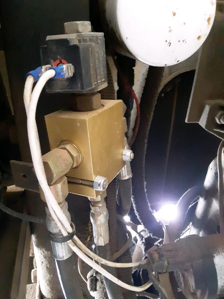

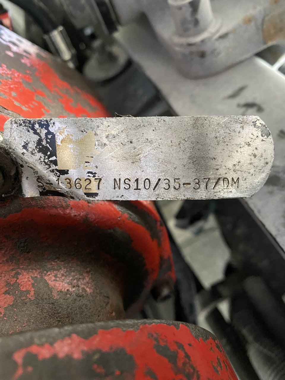

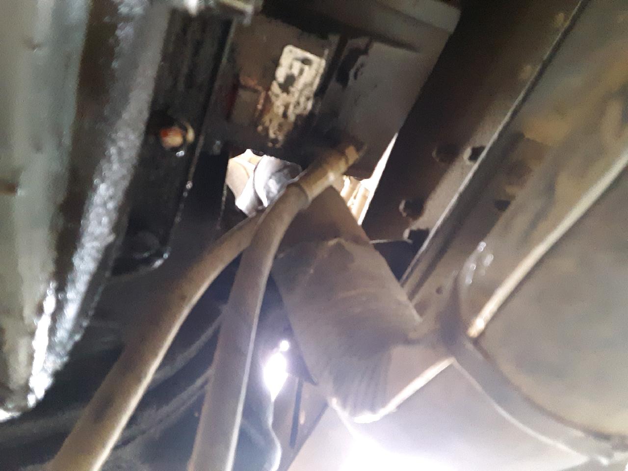

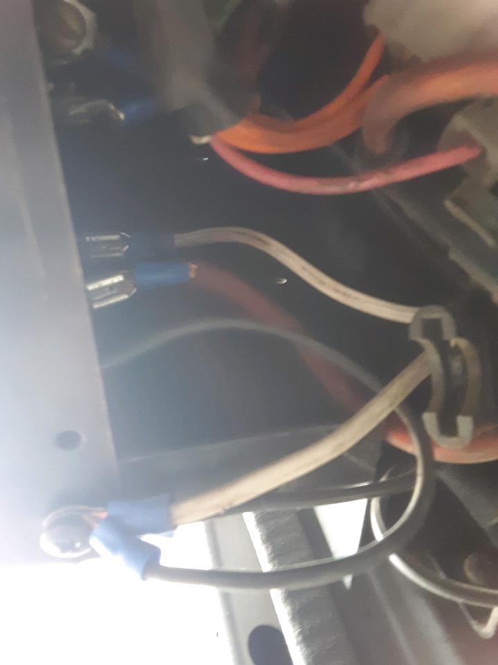

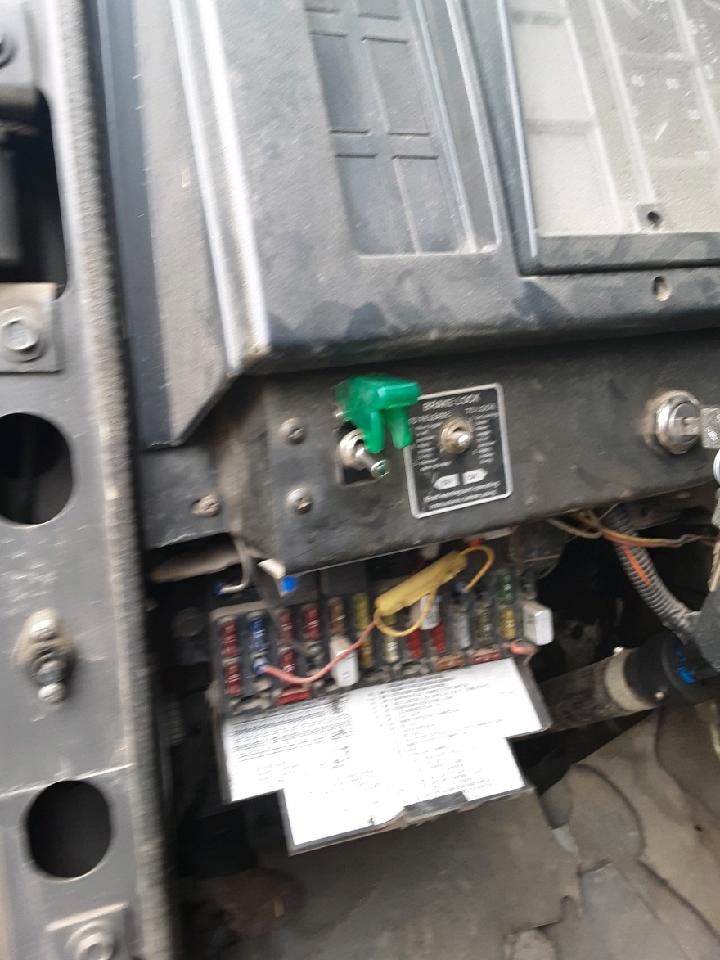

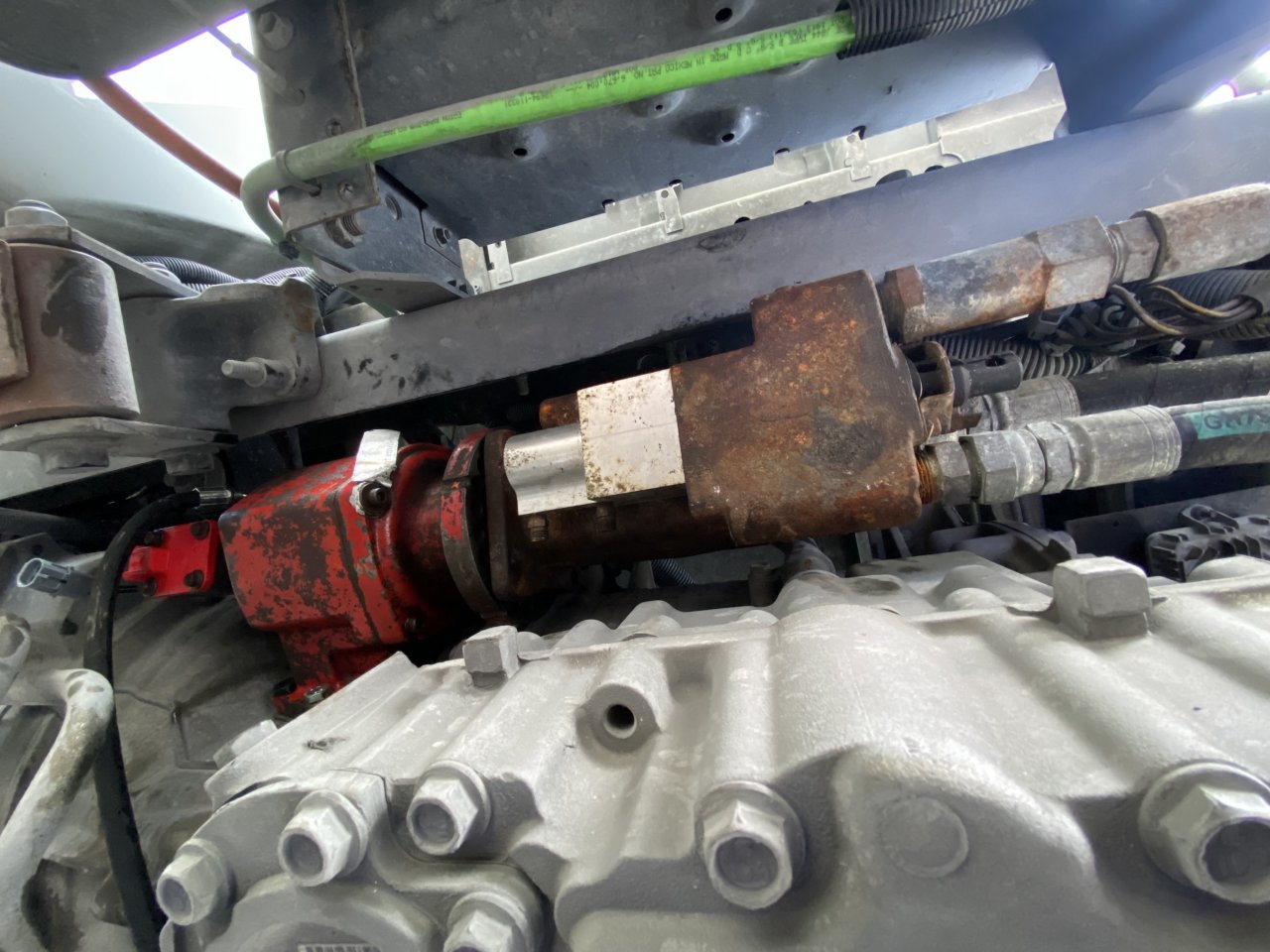

  10. circle h
    circle h Light Load Member
    240
    375
    Oct 22, 2020
    I went and looked here are some pictures. Solenoid is seperate. The power goes from the switch to the solenoid and back to the switch 1100.jpeg 1101.jpeg 1102.jpeg 1103.jpeg
  11. Inderjit
    Inderjit Heavy Load Member
    771
    736
    Sep 17, 2017
    Is there power at the exposed terminals at the solenoid with the PTO switch on?
