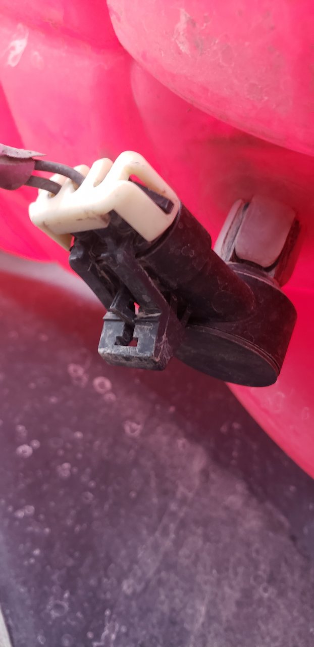

    Cant tell if I pull or twist the old sensor off from the coolant reservoir? Obviously don't wanna "try and find out" then break those clear tabs and be stranded...

    Unclip the three prong that goes into the sensor and then twist while pulling. Be careful though, I think you will loose some coolant.

  5. wichris
    wichris Road Train Member
    4,500
    9,264
    Jan 17, 2011
    If it's cold out, heat it up or they will break.

  7. jason6541
    jason6541 Road Train Member
    2,425
    5,366
    Mar 5, 2012
    Omaha, NE
    Yes, but if engine warm that will suffice as long as engine isn’t scalding

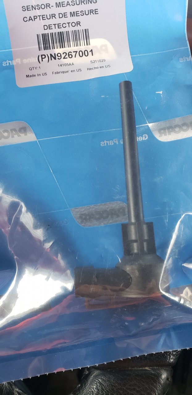

    It came right out. Sadly that didn't fix the "Ding, Ding, Ding, low coolant warning light on the dash....
    Watched a YouTube video that says inside the reservoir is a magnet that senses the actual level...
    Maybe I got a bad magnet and need a new reservoir?

    Could be. But first check the wiring on the sensor. It could be damaged. You can also just unplug the sensor and it will get rid of the ding sound, but have a check engine light on and obviously if you grt low coolant there wont be an alarm. A new aftermarket coolant tank is like $350 at peterbilt. Ive replaced 3 on mine because of that stupid sensor... Unhook hoses and theres 2 bolts on top and it pulls right out. Lose about 3 gallons of coolant of you dont drain it.. Can fix it in the truckstop

    I just pulled the new sensor out, left it hooked up, let the truck run. The warning light went off, put it back underneath the coolant tank and it stayed off... Hopefully when I drive again Monday it doesn't come back on, if it does ill have to buy the new tank.
    Definitely a stupid design the way this is... the sensor was $180 with inflation that tank is probably $600 now :biggrin_25512:
