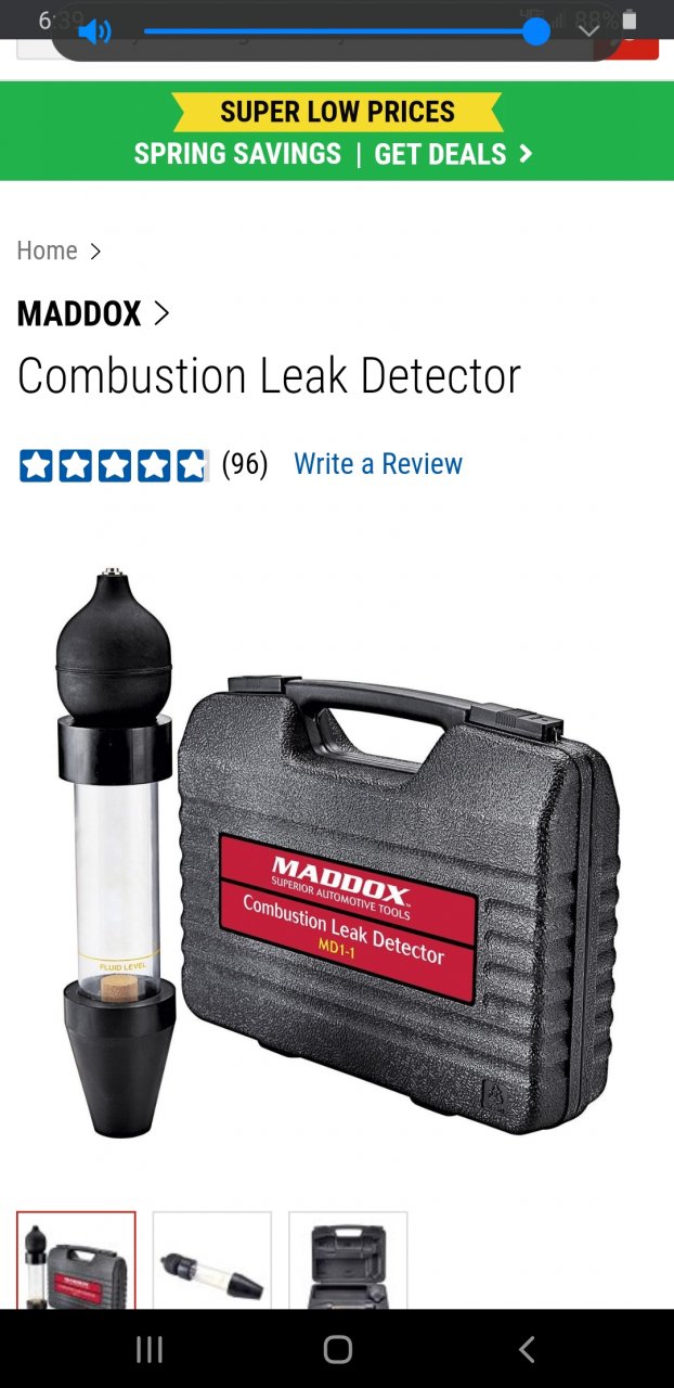

    You think trying to test the system with this first versus buying a new tank would be wise?

    I'd try tank first since other one didn't have issue.

    No need to be sorry. I'm going to try and contact someone from TRP Monday and get some clarification on this. Think I'm also going to get one of those combustion leak detectors that I posted above just for peace of mind. They are like $30 from harbor freight and have really good reviews...
    I'll definitely follow up here with the results...
