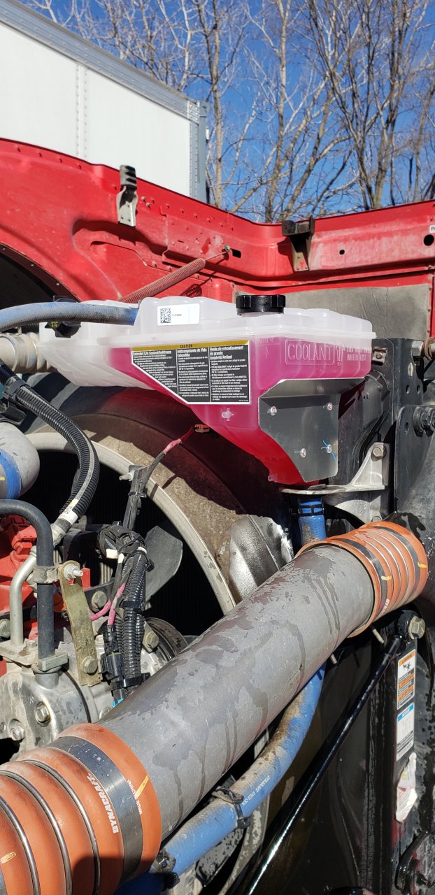

    Noticed this morning my coolant level was below the MIN line. Added some then went to put the cap on and it just spins. Luckily I kept the cap from my old reservoir.
    Tomorrow I'm going back to Peterbilt and buying the OEM tank. Just got a bad feeling with this TRP tank.

    OEM tank comes with new caps- both of them and new sensor.
    I hope you get your money back.
    This is bad to say- but we have a saying of- (T)emporary (R)epair (P)arts. Some stuff is OK, I guess other things, not so much........

    Got the new OEM installed today. $409 from The Larson Group Peterbilt versus $490 from Rush Peterbilt.
    The 3 differences I noticed between the two is, The bolt holes line up perfectly with OEM, the plastic is clear versus milky color with TRP, and the cap threads are a lot better on the OEM...
    Now I just hope that the coolant stays out of the left side, will be driving tomorrow so I shall see.

    Yes sir. Forgot to update this thread... Pretty sure the TRP tank was defective, glad I changed it to OEM.
