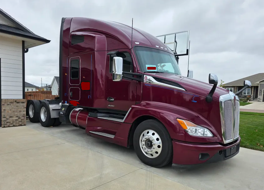

    Alright fellas, I've gone and done it. I bought a tractor.
    I shopped around with financing. Came to a number of roughly being able to afford something that was $55,000. I had $12k, and it took so long to get financing and a truck in a row at the same time that I actually had $19k... I looked on the used market.

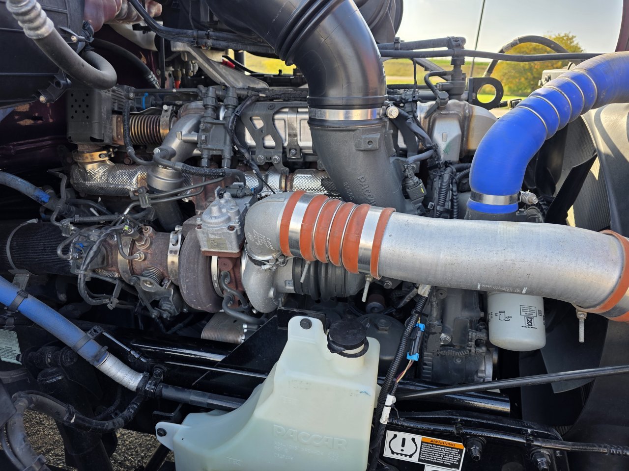

    Anyways, long winded history of my experience with MX13s aside, and having come to realize they didn't perform nearly as badly as I remembered, I inspected a 365,000 mile, 230,000 miles on crate engine 2022 T680 from a nearby flatbed company and couldn't find anything wrong. It had an APU, low engine hours relative to the miles (before I knew it was a crate swapped engine, it was insanely high. Average like 65 miles an hour for entire life of truck.( which is obviously impossible and was the first hint this could be a good find)
    I put $12k down, my payments are like $1500/month for 36 months (criminal interest but whatever, first time semi buyer D: )
    I've leased onto a company, I won't discuss them here. I had the governor opened wide, made sure the latest generation of injectors (PAC2 or whatever they're called) was installed (they were), and I've got everything.
    I'll be running in about a week. Tires only have a few months left on drives, steers are pretty much brand new. Next thing I'll need done is brake pads, it has disc brakes all the way around and they're a little low. Tires in a couple months. Oil change every other month or so (spoke to previous owner about this and a similar 2023 truck for about an hour and determined 40,000 miles was a decent oil change interval using 10w30 low ash synthetic)
    Thing did 9.6mpg bobtail at 80 today. I plan on running 62-67mph. I saw that previously mentioned 10 roads truck do 9.0 loaded to Fargo, I expect good mileage out of this truck down at 62. Will be haulin van... for now.
    APU is winterized (shares coolant), there's a bunk heater as well integrated into the unit. Inverter too, but I think I'd need an extension cord.
    My only beauty standard for a truck was "not white", but I do love the way the last owner specced this truck.
    485hp EPA 21 PACCAR MX13
    3.08 rears
    12 speed auto (my first truck had to be an auto. I have the restriction. Once I'm in business I can get the restriction lifted after buying a manual truck)

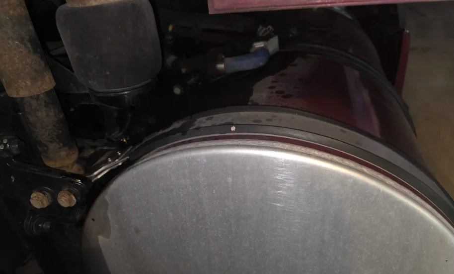

    Found it leakin when I got home. Think I have a plugged up return valve or something. For this kind of problem, I can basically yoink off the line, blow compressed air through to clear it, and stick it back on, yes? I don't really want to go to the dealership for this if I can do it myself.

    Looks nice but I’d be interested to hear how somebody destroyed the original engine in 135,000 miles. Must have just been a bad one. Don’t know about the return valve.

    I’m going to guess an injector tip came off. I’ve heard of the tip plugging and the fuel pressure is so high that it grenades the tip and pieces go everywhere.

    .....welp good luck with that. I got nothing nice to say about paccars lol. Hopefully it wont be the never ending NYC level nightmare dumperster fire mine was before i dumped it.
    That said i see many many MANY red flags. 300k miles. Already had a motor, has torn up brakes (my 579 had the oem brakes at 1 million with 39% left) on a 3 year old rig, i can see extensive rust damage that even my 2017 didnt have. Even my lonestar which was a salt truck has less rust. Though it may just be that specific couple of parts. Hard to see from one dark photo. Its leaking fuel (cant help with that part thats a new one to me too)......has an auto and was apparently governed at 65.
    It also has a crypack on it which tend to be money sinks at the BEST of times when they are the integrated coolant versions. And the high hours indicates it didnt work all that well and may have been idled.....a LOT.
    Something tells me that thing was driven like it was stolen and kicked down the road still wet asap. But hay he may have better luck. Its an EPA 21 and a kenny which i dont have a lot of experince with so maybe?.
    My general advice is to get it into a shop, have the EGR high pressure sensor replaced and the EGR cleaned. Have them swap the DEF filter and test the def quality, may need to flush the tank. Be prepared for a DPF can especially if it has high hours regardless of what they said about the motor. have them check the decomp tube and the doser for issues. Not a comouter check. Physically PULL THEM OFF THE TRUCK and check them. And if its from MHC kenworth. You got screwed. Have them check EVERYTHING at a diffremt dealer. No seriously drop everything. Find a non MHC dealer and tell them to go at that thing like a DoT officer with a stick up his ### and a clean inspection away from losing his job looking for issues.

    Dead on the money. Injector tip at 130k miles. They crate swapped the engine because of it.
    I'm not really sure why one of the brake pads is near needing replacement, but everything else is pretty normal and makes sense with this truck's history. And year that shock right there is mighty rusty, the rest of the truck isn't. Thing was cleaned pretty often from what I could tell, as the frame, driveline, suspension in general had very little rust and I could tell it was the original factory finish and not a black spray paint can like some of these dealerships love to cover everything with.

    I haven't had the fuel tanks completely full since acquiring the truck until tonight, so I didn't notice my return fuel issue.

    Here are some photos I took the other day, shows what I mean about most of the truck not bein rusty 20251018_105838.jpg 20251018_105936.jpg 20251018_105959.jpg 20251018_110001.jpg 20251018_110047.jpg
