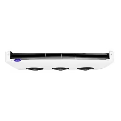

    If you were doing delivery work, the mushy boxes are condensation from having the door open. Otherwise, it’d be from the tray overflowing.
    A lot of customers won’t load a multi-temp trailer, because of the ceiling units getting destroyed by forklift operators. Also, some shippers know a multi-temp won’t have the air chute all the way to the back of the trailer, which affects airflow and cooling consistency. You gotta be really careful with your choice, here. Again, the Carrier units are much better at cooling, draining out, and the ceiling unit is lower profile.

    Definitely the kind of trailer to only acquire after lining up work some type of way. Carrier seems to have it locked down. That height is real valuable.
    Basically, if you aren't actually doing multitemp LTL stuff, the trailer begins to have substantial drawbacks if I had to settle back into normal reefer freight.

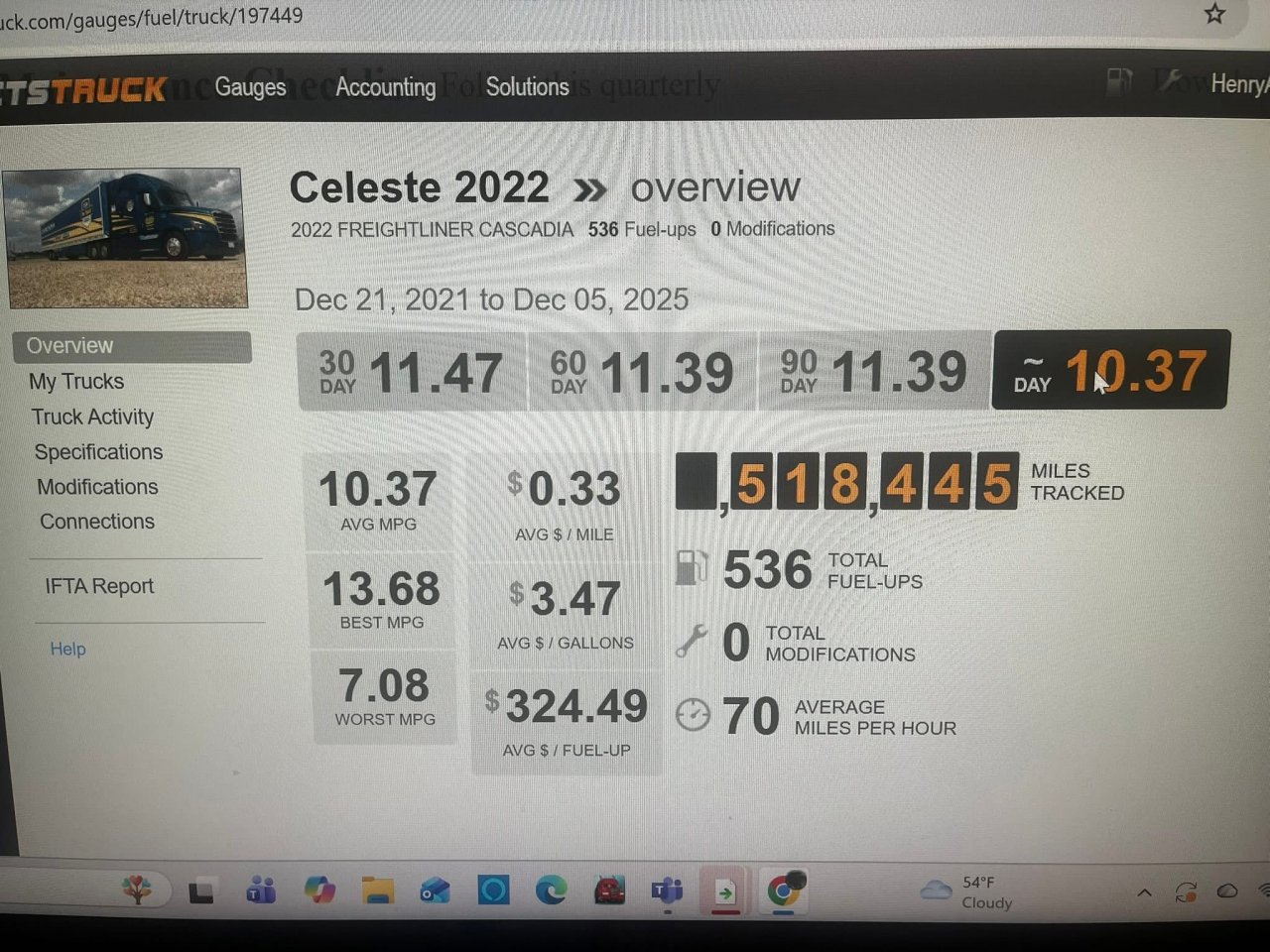

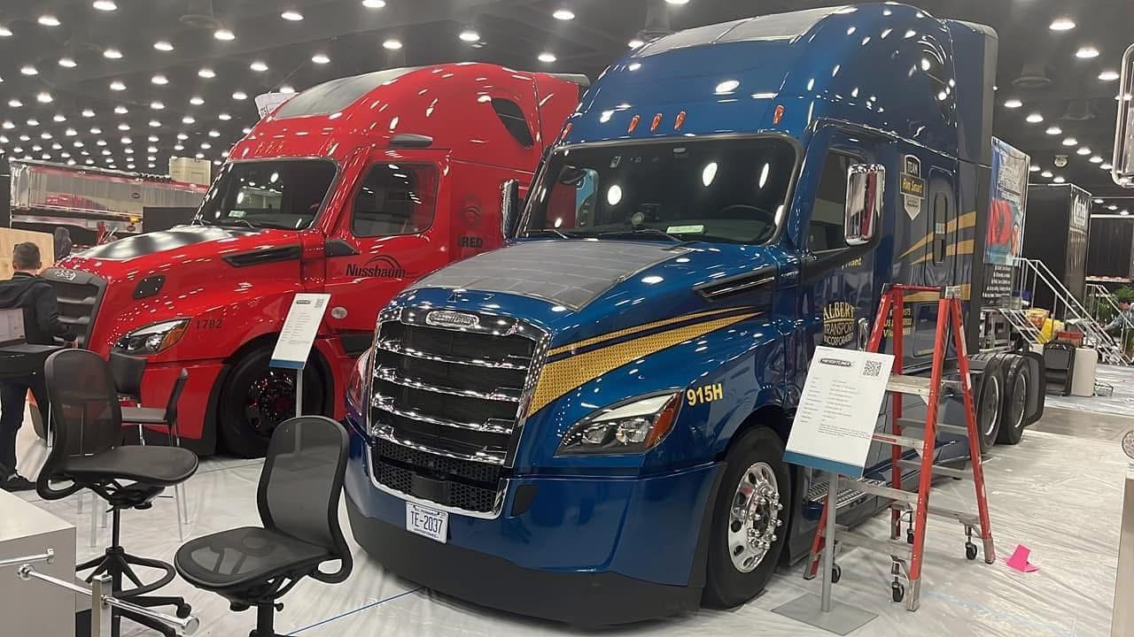

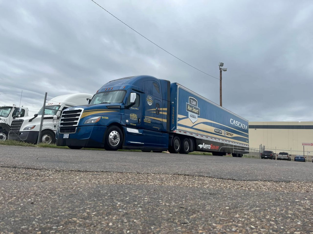

    Look up Henry Albert. He’s part of Freightliner’s “Run Smart” team, where they directly work with Freightliner on ideas. He uses a Hendrickson lift axle, which is a Freightliner/Western Star option. The middle pic is at MATS, with two of the best MPG trucks in the country representing Freightliner.
    I wouldn’t touch the new Volvo/Mack, as they have way too many issues. Give them a couple years to get the bugs worked out and they “might” become a decent truck. However, with the amount of electronics, I’m doubting it. Just too much nanny crap and electronic oversight in them.
    IMHO, the turbo-compounding engines are what returns the best fuel economy numbers, while still performing well. PACCAR engines get the mileage they do, because their fuel mapping is set up so soft to the point of not performing. They simply don’t accelerate or pull worth a crap, compared to a TC engine, because the fuel delivery is cut way back. And, a TC engine will pull much harder at very low RPM (<1000RPM), which helps fuel economy. A PACCAR won’t. There’s nothing wrong with a Freightliner and its Detroit Diesel engine, which is TC. They were the first. Nussbaum’s fleet average is in the 9’s and there’s a reason. Plus, they’re active in experimentation with Freightliner involvement.
