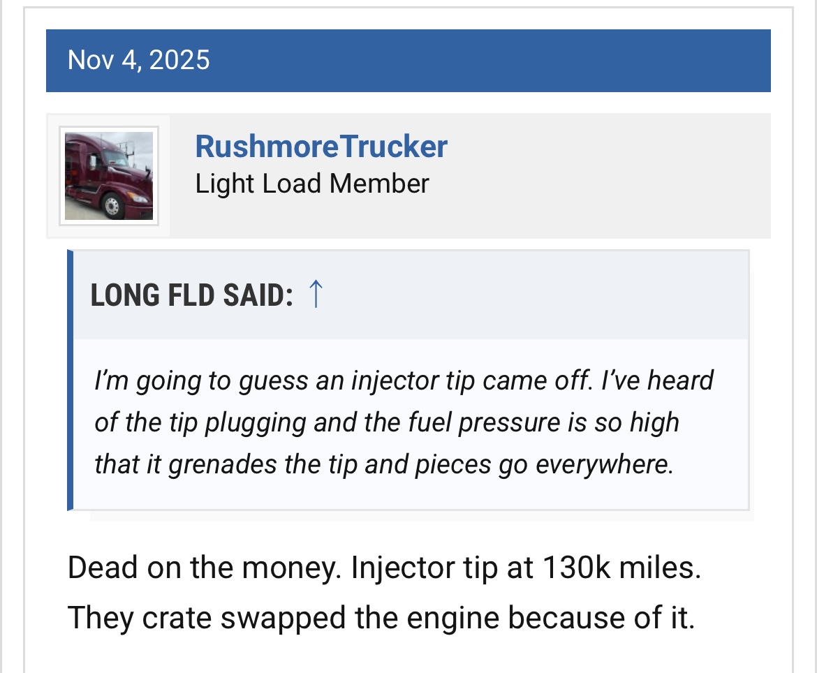

    This is why I shared my recent experience in this thread he created.

    Precisely, this is why I was able to get a truck with as young a motor as I did. I gambled on that particular issue being solved or not. I'm curious what particular injectors were in that truck, but it happening in a 2024(?) newer version than mine is interesting.
