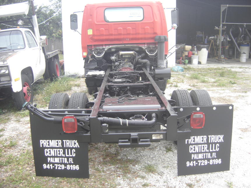

    I'm setting up an Isuzu NPR 14.5 GVW, 4 cylinder diesel / 4 speed, overdrive auto trans w/ ECM, to tow my 3800 Lb. 5th wheel trailer. Adapting a Reese 20K double oscillating (4 way) receiver to a class 8 air slider, allowing me to move the pin from 13 inches, or so, forward of the rear axel centerline to about 14 inches behind it. When I'm done, it should be easy to fine tune the ride hight, handling, axel weight distribution, leveling. Also replacing the stock springs with air bag's behind the axel centerline on a parallel 4 link setup. (mostly because the ride is much too harsh with the 14.5 GVW 10,000 Lb rear axel steel springs.)
    Interestingly, Isuzu does not rate the "N" series trucks for towing, most of them are box trucks. Mine was a 20 foot box on a 167 inch wheel base. A local upfitter cut the WB to 120 inches and recalibrated the ABS system, along with adding a brake controller and a 7 pin plug and an ICC spec dock bumper.
    Some of the landscapers, local to me, fill a dump bed with wood chips and tow a 8 or 9 K lb. chipper behind, with no ill effects and get high teens mileage doing it. Comments?

    He needs to post some pictures
  11. red caddy
    red caddy Bobtail Member
    12
    5
    Jul 8, 2017
    these 2 pic's ought to help.
