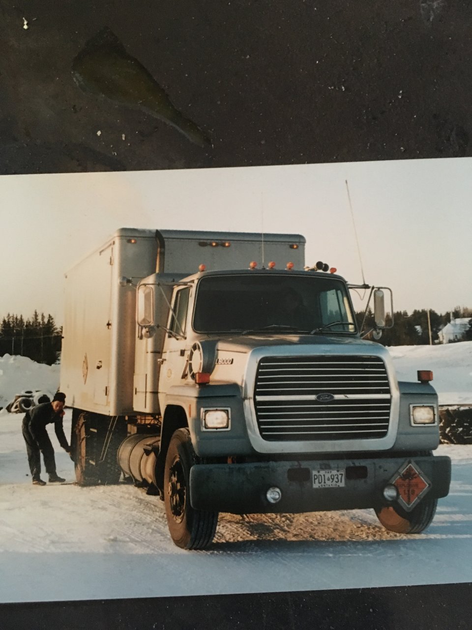

    image.jpg 16' will hold 6 pallets. You really should have a dealer determine your specific needs. You definitely want diesel for fuel economy. The truck in pic has 16' box and could be licensed as high as 32,000. I'm not familiar with the newer small diesels but this one had 3208 turbocharged and got about 12 mpg highway, doubt new ones are much better but just lack the reliability
