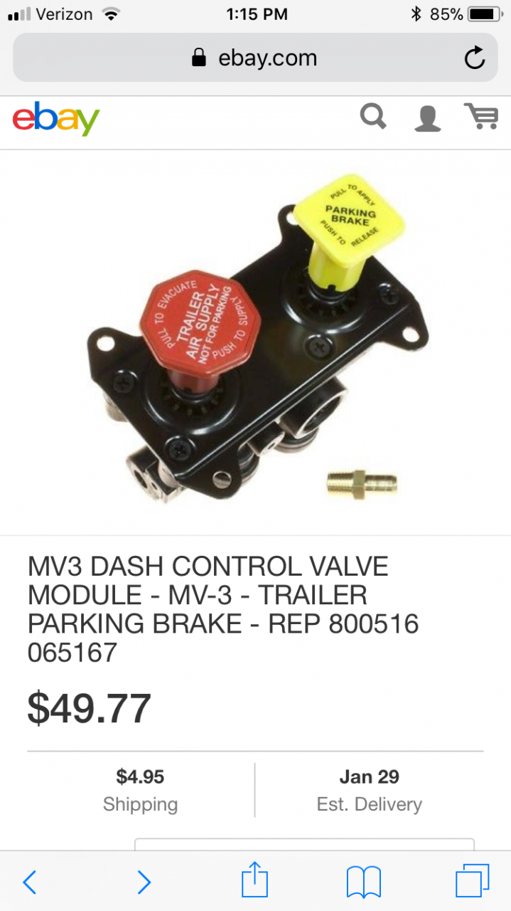

    Won't know till tomorrow. I'm probably going to end up getting it from the dealer in OKC tomorrow provided they have it.

    Actually just found fleet pride has a location in OKC, hopefully they have it.

    Just replace the o-rings In the fittings that are bad.
    I did a write up with pictures on here of mine that I did last year. (Still working great)
    I will have to look and see if I can find it on here and post up the link.

    Ya, if your able to find that thread link it please. Do you recall where you got the Orings?

    Got the o- ring kit at harbor freight.
    It was dirt cheap..

    Found it but don’t know how to post the link lol.
    If you do a search of the freightliner forum under:
    My repair of a tractor brake/ trailer supply valve you should find it.

    Yes I did. Thank you. Going to head over to Harbor Freight tomorrow and get that assortment of orings. What was the purpose of the lube, to slide them on easier?

    Yes the lube makes the air lines slide in easy with out tearing up the new orings.
    Harbor freight also has a cheap set of oring picks that help put the orings in the slots.
