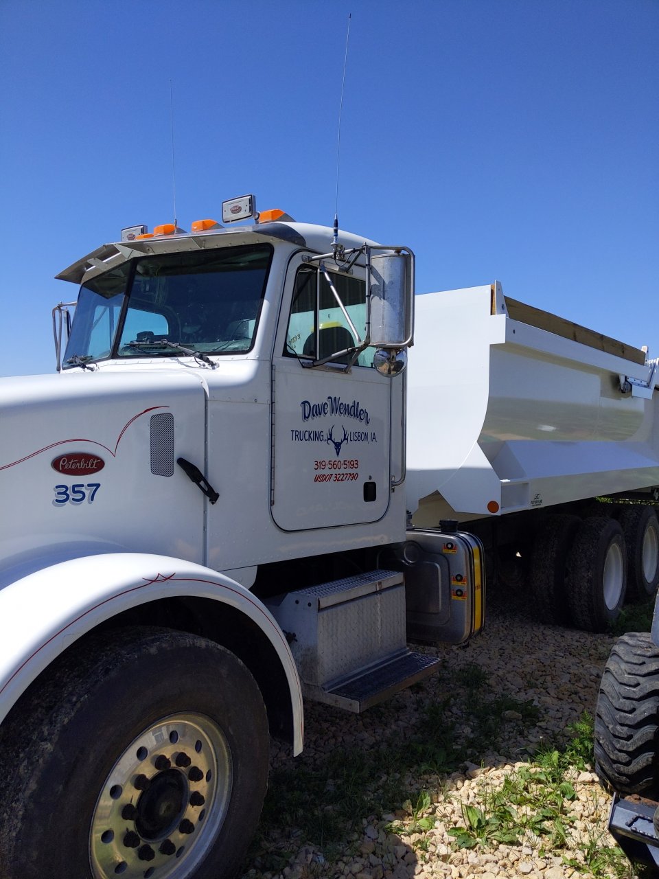

    Haven't had a chance to do an update on my build. Got it all put together, had Future Line in Cedar Rapids, Iowa build one of there Tuff Bodies for me. The body is a demo style made of AR450, highlift, coal shoot and powder coated. So all together I have a 2000 Pete 357 with 20k front, 46k rears, 4.88 gears, Chalmers suspension, Allison 4560 trans, and Cummins ISM (380hp), the Tuff Body and all hydraulics and cylinder installed and have $54k and some change in it. Pretty have with how everything went together and how it looks. Sorry for the delayed update on it, happy truckin! 15958792992278104869234399095847.jpg 15958793424103015128163001916791.jpg

    Was that truck a truck tractor or was it some other type of vocational truck?
