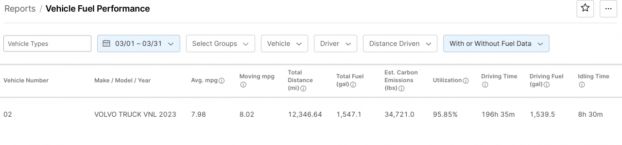

    Yah, you’re probably right and I’m underestimating how much fuel I burned up sitting in SD.
    Just went back online and paid the damage and left a thorough note with the return. Probably get flagged for an audit now if my mpg shoots back up.

    I got Fleet Complete Hub and it’s showing 63% idle time, haha.
    Don’t know how accurate it is but it sounds about right. Been doing a lot of sitting lately trying to get decent rates.

    Ouch, That would for sure account for that amount.

    If you’re not tracking tank to tank it’s hard to say. The tanks where I had to idle all night were obvious, as well as days of terrible wind, and many tanks that were completely normal for the terrain and payload. I’m sure if I looked at the quarter as a whole things would appear off and I wouldn’t know where to start looking.

    @Concorde. Above is the most important post.
    Who cares what your telematics or bs quarterly reports can tell you, track your mileage every single fillup, use google sheets, gallons, mileage, 1 more cell for calculation and 1 cell for a note on high idle, problems with tires, etc, youll be able to see how weather cold idle, good fueling stations and bad affect your mpg

    That way I definitely would have known when the problem started and why.
    Never really had a reason to keep track like that since my quarterly reports were always the same…and I tend to get lazy about stuff like that.
    Now that you mentioned wind, that is definitely another reason for the difference. Seems like everywhere I went lately I’ve had a strong headwind.

    Colder denser air and winter blended fuel, I usually lose at least 1mpg during the first quarter.
    As far as running the overhead on a Cummins, I would do it a minimum of every 250K miles, I personally get it done once a year.

    Colder denser air should help performance as that is the purpose of after cooling. Not enough to offset all the other factors though.

    The winds coming from the northwest have been killer down here this season. I burn 10% more calories walking 200 ft from my house to the shop in that wind. Big truck does the same. Lol.
