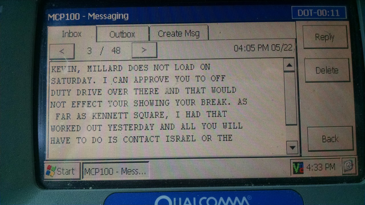

    Do not let your company give you any order over the Qualcomm that is illegal. A certain Reefer company lets call them L and C, has dispatchers who tell drivers to line 5 somewhere or to creep over so as not to trigger the Qualcomm. Take photos of anytime they do that and save it. You might need it later.

    Yes they will try... And yes take a picture

    WOW! Their really stupid enough to put it in writing like that huh? That's awesome. "I can approve you to off duty drive" HAH!

    That's ballsy as hell. Sheesh
