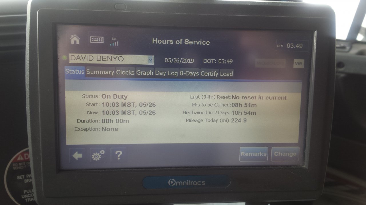

    Here's mine. Today's Saturday the 25th.
    So at midnight Sunday, I'll get 8 hours 54 minutes back for Monday the 27th.
    Dieselboss Thanks this.
  7. Dave_in_AZ
    61,541
    432,680
    And here's today. So easy, even I can do it. See how I'll get the hours back at midnight.
