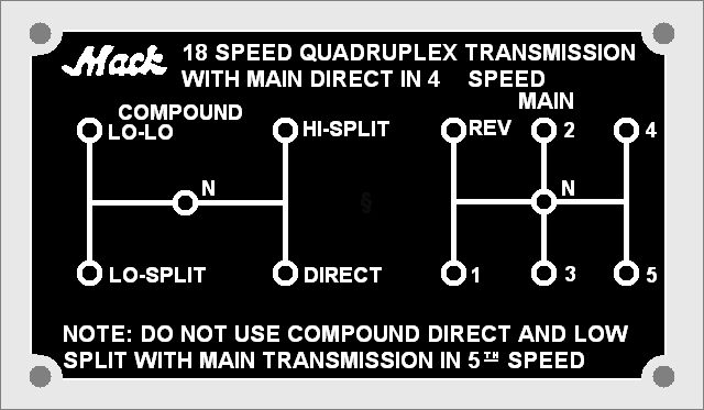

    I liked the old quadruplex, you always had the right gear when you needed it. Just unhandy shifting the compound through the steering wheel. Moved lots of big iron with it , 1967 R-600 250hp quadruplex 44 Mack rears , slow but sure. Top unladen speed 62 mph but , I got there and back. Gee whiz that other shift pattern favors a 1000 piece puzzle , not sure if I got enough time left to master that?

    In parking lot trailing ( that was one lap around the the parking lot with someone that could shift it ) I was told if you ever miss that shift you will never get it in any gear. Me myself and I thought B/S. I will get it in some gear.
    Stopped at the end of the interstate ramp and started from the beginning.

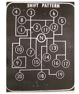

    What truck is that 2nd image from?
    Rideandrepair and jason6541 Thank this.

    I'm pretty sure that's a made up gear pattern. LOL

    I think the Econodyne was the 237 or the Maxidyne? @Brettj3876 probably knows.
    I think the thermodyne was somewhere around 175 horsepower, lol. They were in the B model Macks.
    Is that the quadruplex that I posted? Mack had a lot of really cool heavy duty compound Transmissions.
    They said it's from a three stick Kenworth. I don't know why they have it shown like that but apparently one is a main shifter one is a high low and one is a splitter.
    Watch this guy shift it! That's insane!
