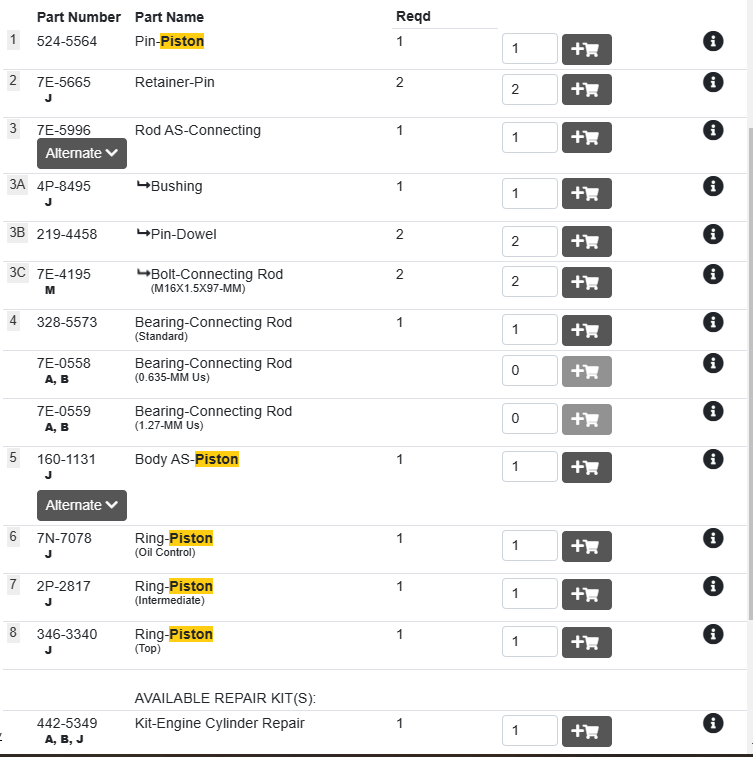

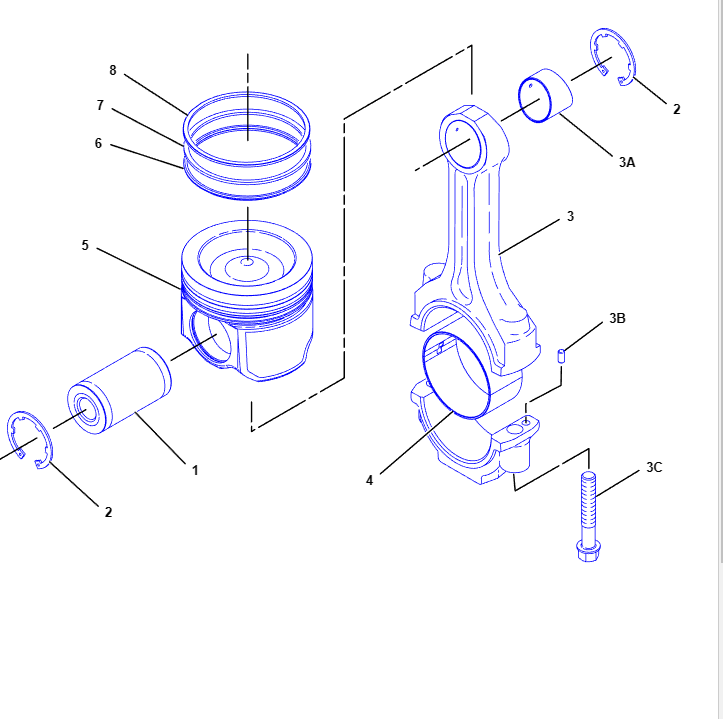

    Sorry 1 other question I was just searching online for the 5YG pistons most of these sites require a engine serial number before ordering and I’m assuming if I went straight to cat they’d ask the same thing, how do I go about this just ask anyone who has the 5yg prefix to let me get there number so I could buy parts or is there specific part numbers I should look for instead?

  5. Oxbow
    Oxbow Road Train Member
    13,683
    141,905
    Nov 24, 2015
    Maybe this will help:
    5YG parts1.png 5YG group.png 5YG piston.png 5YG parts1.png 5YG group.png 5YG piston.png

  6. wore out
    wore out Numbered Classic
    17,431
    216,962
    Jun 5, 2013
    CHASIN THE DEVIL'S HERD
    5YG00466 is my serial number. They were all PEEC’s, all 460hp and only produced 1 year 1990.
    160-1131 is the piston number. Now this is not a steel top. It will stay together however if you don’t get greedy. I have also used the IPD enhanced durability kit with the 7031 nozzle and a 7FB pump with almost as good a result. To improve upon the 460 bottom end with that 7031 nozzle you’re gonna need to spend a lot of dollars to actually feel it in the seat. I had one built that way with a 4MG pump on it with the static timing at 21, start of advance at 1375 which was maybe a little early but the advance was always lazy and I was compensating to get what I wanted at 1600. Anyway it put 530 to the ground with the pump set 10 percent over. No smoke and 6mpg pulling a welfare wagon. All around one of the better combos I’ve run
