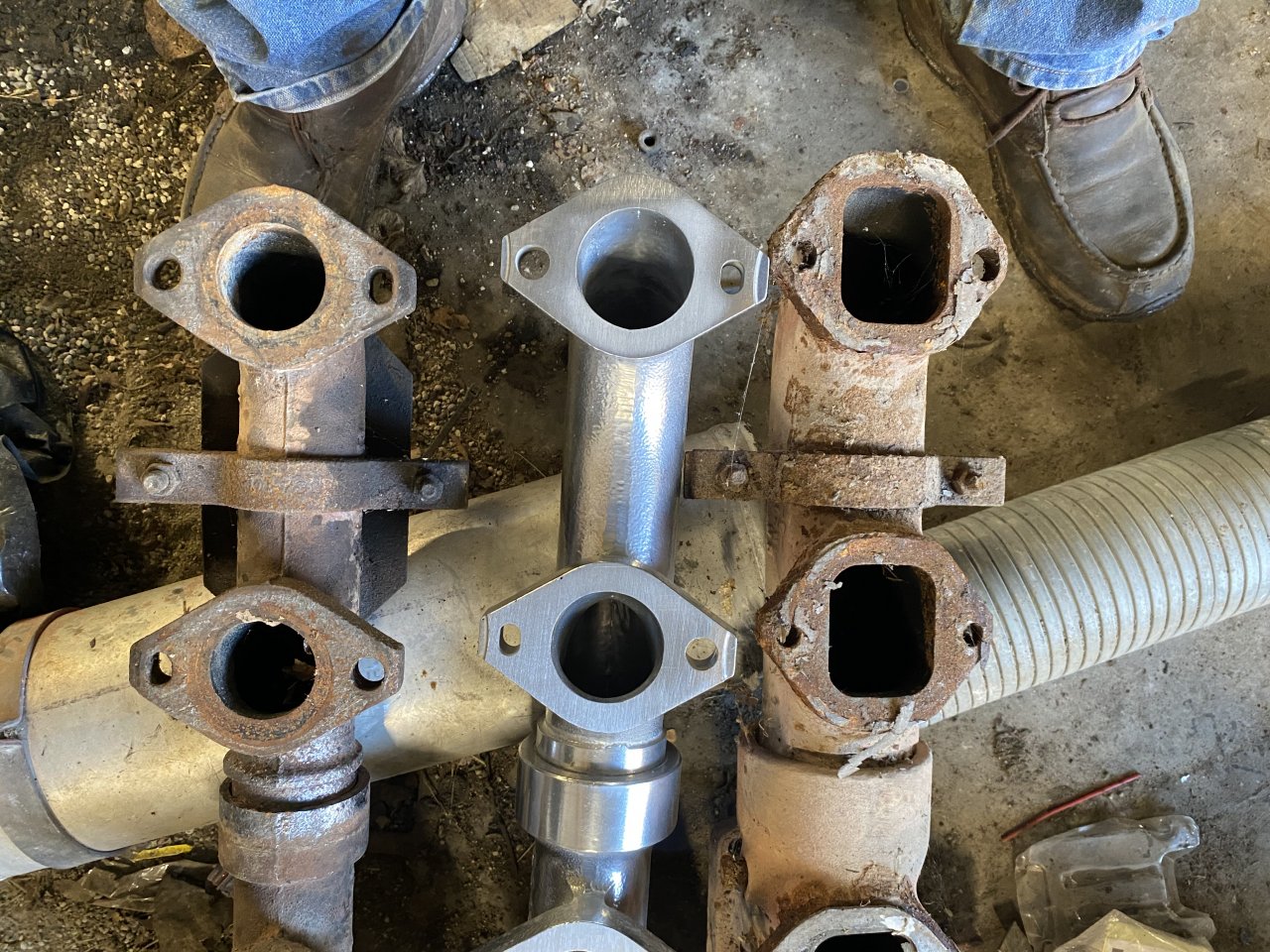

    The square style is what’s on my 4MG.
