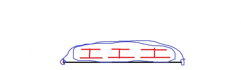

    steel is hard to secure, loads like that 'I' beam I always choked the front and back by wrapping a chain around the load

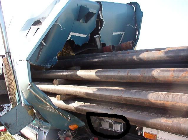

    No matter if he had chains or not your not gonna stop a load like that from coming forward in a sudden stop like that driver went thru. He did in fact have straps on that load when it should have been at least a mix of straps and chains. Way to many edges on a load like that and alot of odd ball shape steel.
    When it comes right down to it you can chain and strap all you want but the sudden stop will either brake the load loose or brake the fifth wheel off. Seen more than a few loads come thru the front of dry vans. Take the plywood out and the only thing left are upright posts and the outside skin of the trailer. Vans are kinda outta sight outta mind were flats you watch the loads.
    In the pics below chains were used. Question is was there enough chains on the load.

    i dont see any chains or a headache rack...course its hard to tell....we never had a load move on us..EVER...and we hauled a variety of things...

    Look close in the first pic, you'll see the base of the headache rack on the frame of the truck. The rest of it is in the truck.

    [​IMG]Base of the headache rack is in the black circle.
