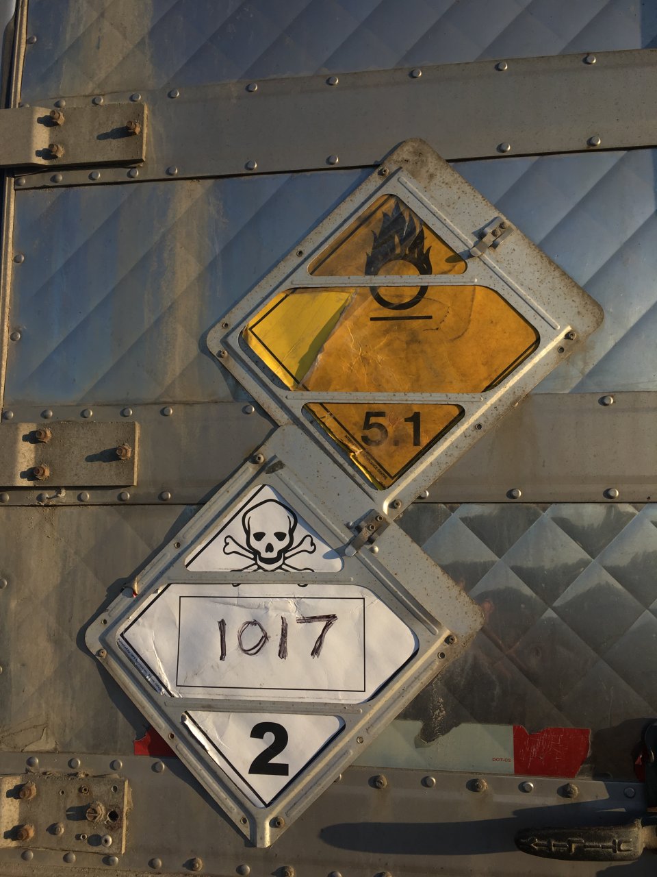

    Class 3 (Flammable) has to be placarded if it’s 1001 lbs or greater. And manually writing UN Numbers is no good, get numbered stickers and use those. You can pick them up in bulk fairly cheap online or just pick them up at any shop or retailer.
    Jazz1 Thanks this.

    ThAts what I was told and then I hook up to this. I will be using my crayons for a while yet

    I would run a regular class 3 placard for the diesel, and a blank class 3 with “1203” for the gasoline.
    We hand write UN numbers in a pinch, but truth be told I sure don’t like to.
