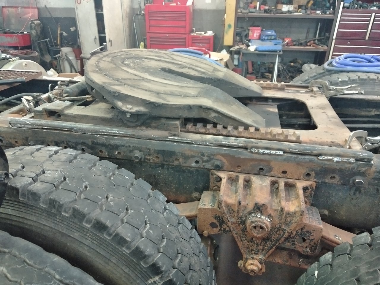

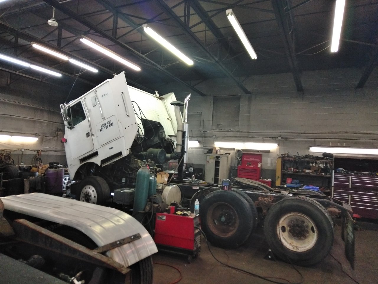

    Alright, time for another update (for those who are interested/care).
    Got their 5th wheel on my rails, and welding it back onto the frame. The owner of the company took a look and mentioned it needs some new water lines, and the belt for the water pump was coming apart (mechanic mentioned that a while back, just didn't get to it).
    Automatic slack adjusters put on the drives, and will put them on the steers after a month or two of running.
    Also, will upgrade to Alcoa rims on the drives, with virgin rubber. They said 2 of the drives were recaps, but all the rest were virgins (too old to recap if needed), but looked reliable enough for a few months of running.
    I am hoping it'll be done in the next 2 weeks or so. 5th wheel.jpg Side view.jpg
  6. 650cat425
    650cat425 Road Train Member
    1,548
    11,044
    Jan 26, 2020
    Pennsyltucky
    I'm glad to see you're sticking with the project and your end goal. Also, thanks for the updates... it's pretty cool to watch it all come together!
    I wish you the best of luck and will keep watching as the progress continues.
