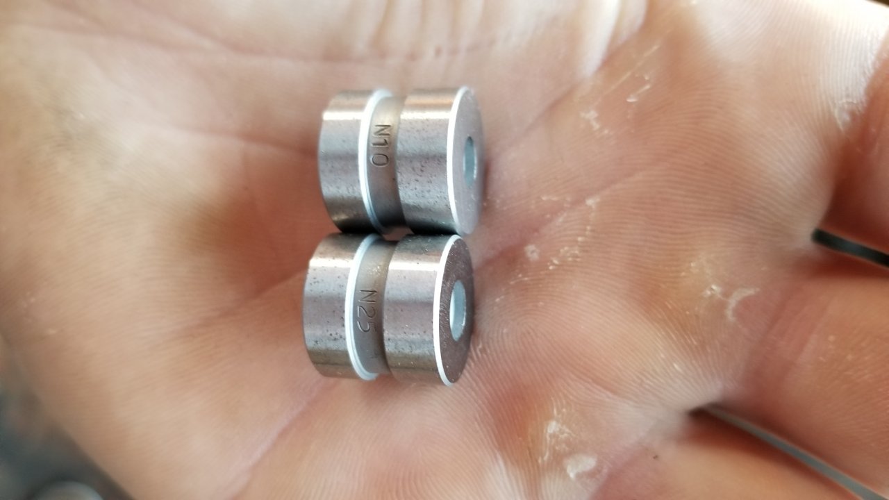

    I've got a couple items that could be helpful with them hills... you would need a functional pyrometer though! 20200804_202144.jpg

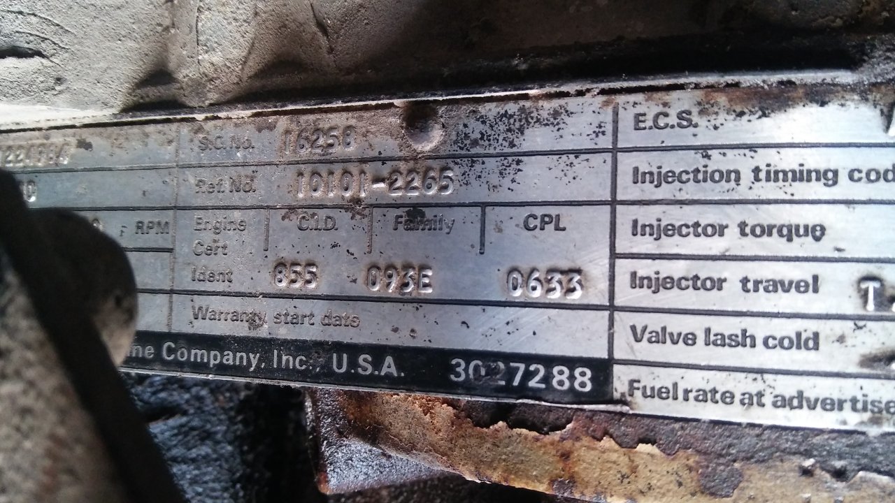

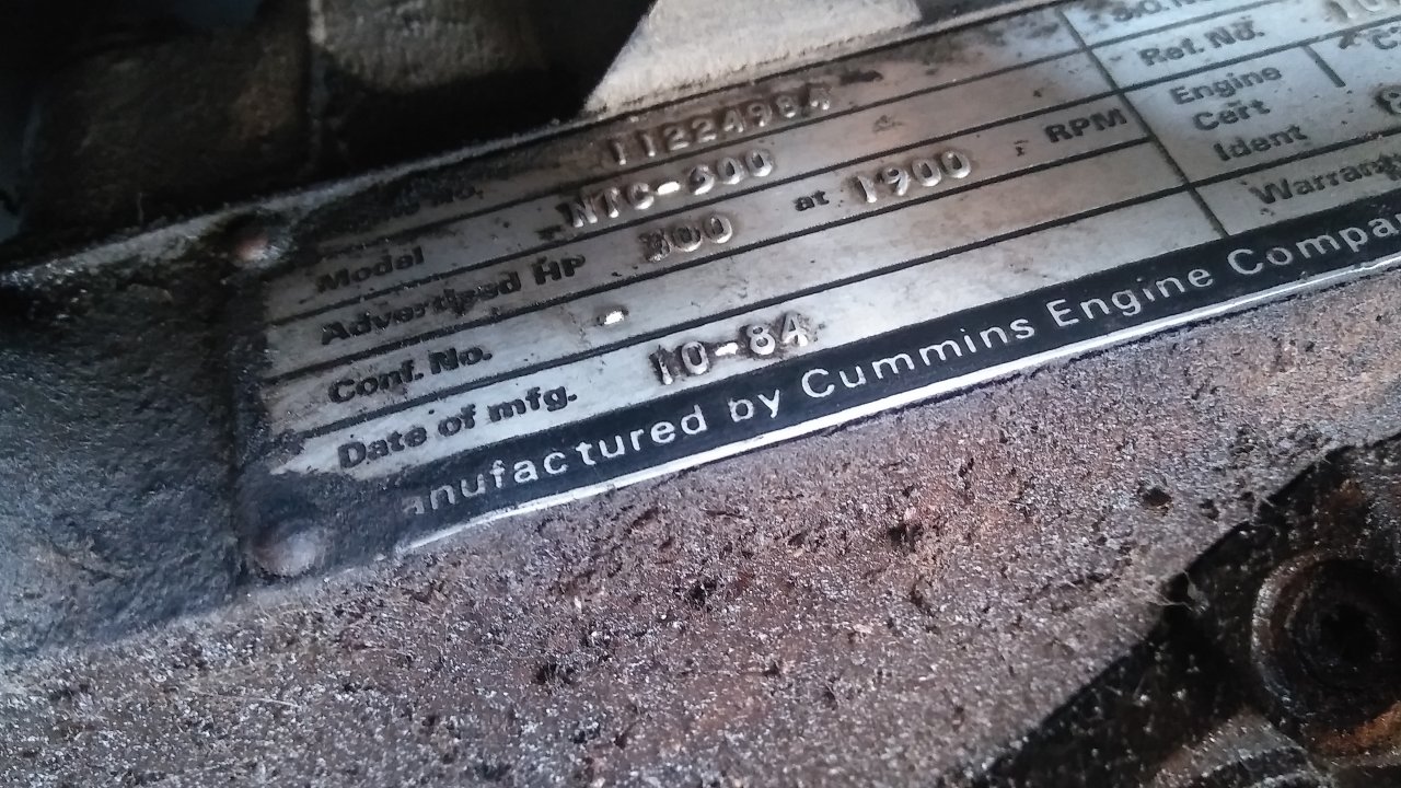

  4. 85COE
    85COE Light Load Member
    242
    505
    Aug 6, 2019
    Columbus, Ohio
    are those bushings?

  5. Dino soar
    Dino soar Road Train Member
    4,827
    27,075
    Dec 8, 2017
    The tag says 855. That is the cubic inch displacement of the big cam.
    And whatever you do if you're going to turn the horsepower up learn all that's involved with the dangers and whatnot and make a good decision.
    Don't just turn the fuel up or change the button.

  6. LameMule
    LameMule Road Train Member
    1,148
    7,418
    Jan 19, 2020
    Montana
    They're buttons for your injection pump. They increase your fueling substantially. One is a #10 and the other is a #25
