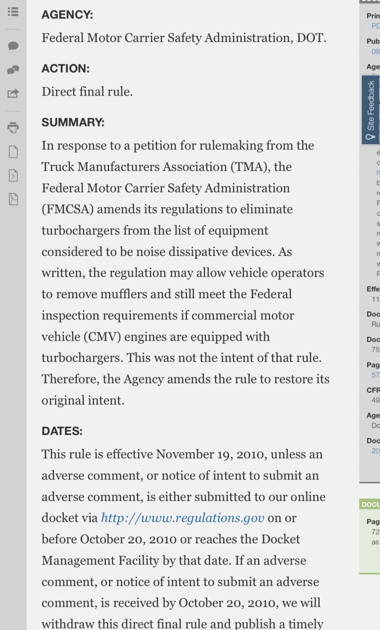

    D9429426-7EB6-4D30-AA87-61F363A54460.jpeg This is something I found on the muffler issue. I knew mufflers were not required on a turbocharged engine they were optional and most manufacturers didnt really make them standard until the late ‘70’s. Dot always wanted to make it seem illegal to not have them. Well looks like up until November 19, 2010 it wasn’t. Assuming the usual gooberment grandfathering clause that always goes with this kinda thing anything built before that date should be exempt and can be loud and proud.
    I do find the date interesting on how it coincides with the def fluid emissions time line.
