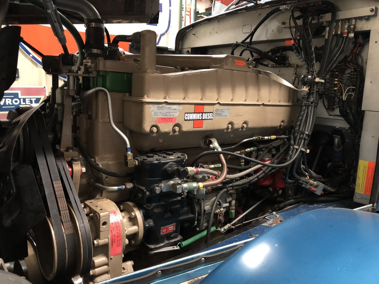

    This is my NTC 350 855 SC in my ‘67. It is from one of my uncles old ‘74’s. FFC and suitcase waterpump. Looks like any other early big cam that came out later.
    Engine should be painted white in a Pete since ‘65 but I like the cowpoop beige.

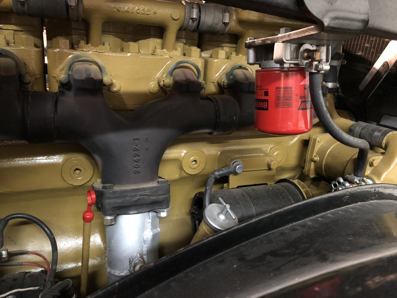

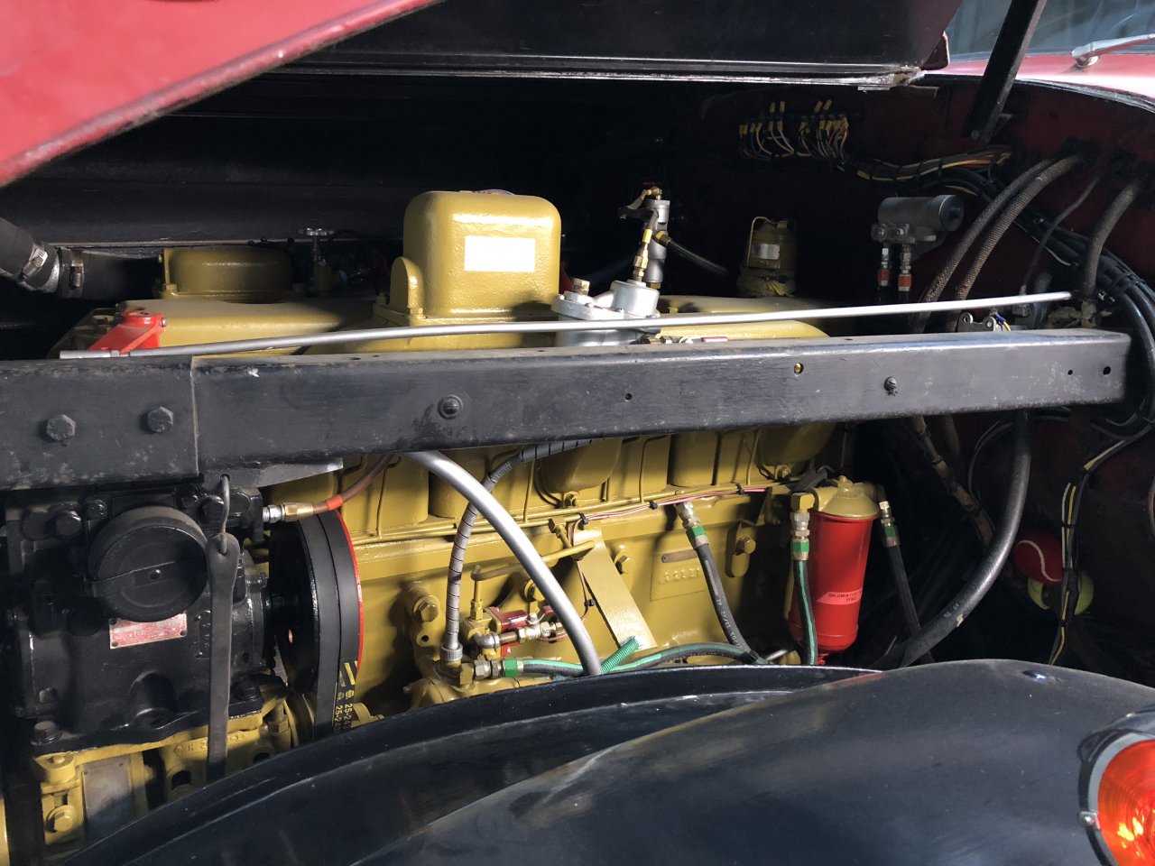

    This is the NH 220 743 in my great grandfathers ‘51 Diamond T. It was originally a NH180 672 cid when he bought it new. Then in ‘58 it was overhauled and the larger bore NH220 liners were installed to make it a 743 cid. A very common thing to do back in those days. Also at that time the old disk pump was replaced with a PT pump. It has to be solidly mounted because it has to have the pulley on it to drive the air compressor belts the retrofit cast iron bracket that mounts it to the block weighs around 7 pounds. The generator on rh side is chain driven off of front gear train were they would have mounted the supercharger on the 2 and 6 bits 275hp or 300hp NHRS 743 cid’s. This is the only truck in our collection that has the fan low mounted and bolted directly to the end of the water pump shaft. Everything else we have they are high mounted on a hub above waterpump.
    Put it next to a 855 bc and it is the same size block and heads externally. Looks shorter height wise because of no aftercooler, turbo, or Jakes. It’s a very tight fit in this truck and sits pretty low in the rails.
    The “Old Gold” was the prettiest color Cummins used. IMO.

    That's some very interesting information.
    I did not realize the 250 was an 855. As I write this I think I remember reading that somewhere or seeing that, but I always associate the 855 with the 270 or 290 and up Cummins. Probably because I used to drive them. With the compression release and everything, lol.
    And I did not realize the small cam uses the same aftercooler as the big cam. There is always more to learn..
    You're right, that looks just like a big cam.
    Can you post some pictures of that truck? Wow that engine is really stuffed in there! Is that a butterfly hood? That engine looks like new.
    I bet that's a nice truck. Nothing like old iron.
