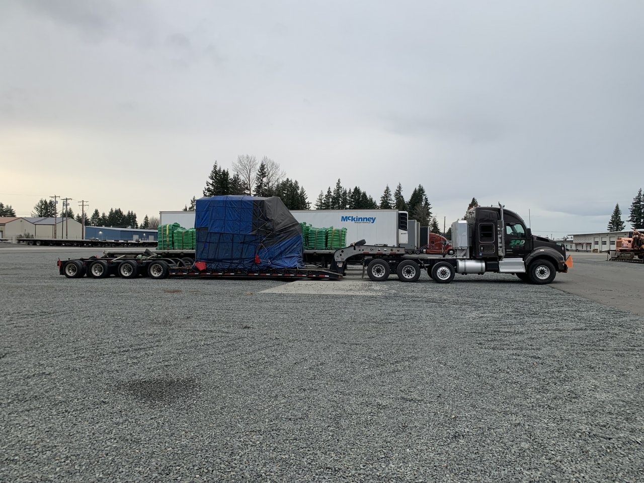

    I’ve been tossed into a slip seat 4 axle truck and a 4 axle 55 ton rgn. This is just temporary while my normal truck is in the shop. We don’t have steady enough work to keep this truck busy but do occasionally book loads for this truck when the money’s right.
    Anyway my question is what state split out the pusher axle from the drive group? This truck has a 5’ spread from axle 2-3, and a 4’6” spread from axle 3-4. The lift axle is set up on common air with the drive axle suspension.
    The issue is the drives and pusher are not splitting weight equally. Wyoming weighed my pusher at 11,000 and the drives together at 37,500. According to the two air gauges on the dash both are between 60 and 70 psi with the pusher being the higher reading.
    Where will this be an issue? Would a say 1” thick shim above the lift axle airbag help even the weight out?

    And here’s a picture of the offending setup. I didn’t load the truck and trailer, this load is honestly two light for this setup. The fifth wheel should also be farther forward in my opinion but permits were already issued. F6B5DA5D-DBA9-4A5D-BBA1-7F9A96F79216.jpeg

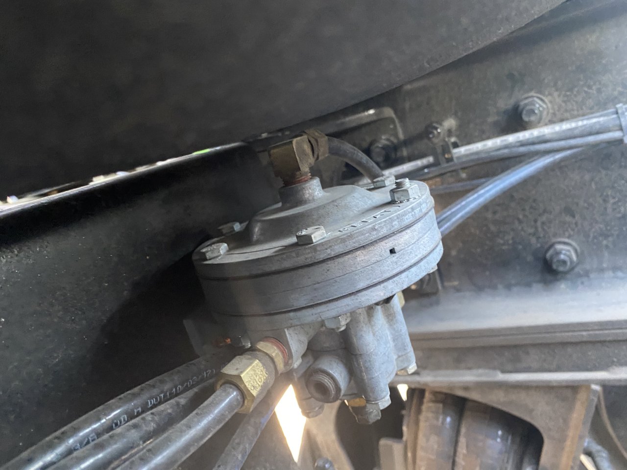

    Does the lift axle have a regulator valve? If not does it have a proportioning valve ( if it were running a California inspection report to allow it into California as a 4 axle)?
    It would look like this….
    cke, Rugerfan, bumper Jack and 2 others Thank this.
