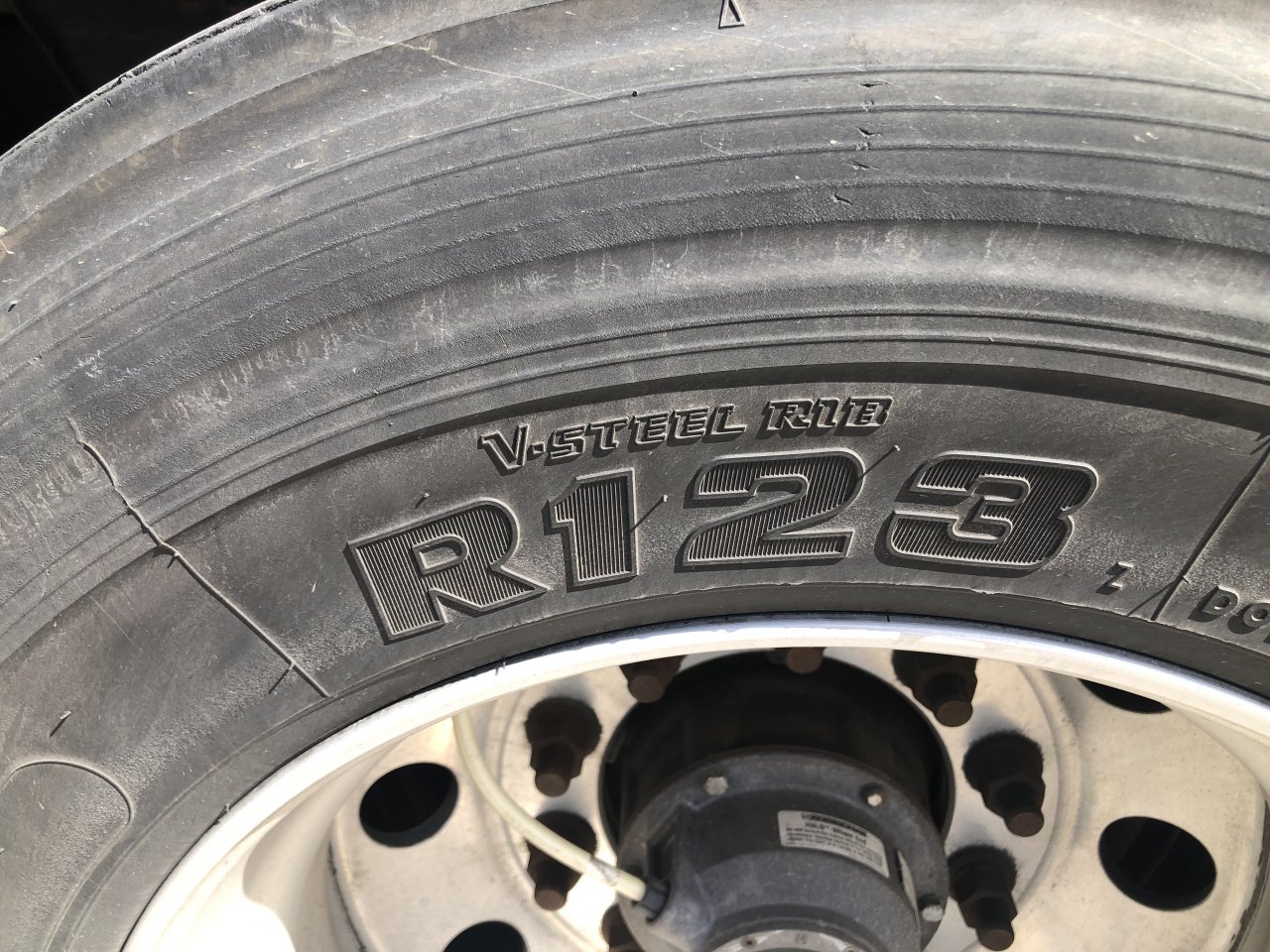

    Just get trailer tires..keep it simple.
    I run Bridgestone R123’s lo pro on my Great Dane.
    They were pricey last time I replaced one but maybe you can find a better deal than I. I paid $650 for one at a TA.
    So far I got 300,000 on them and looks like another 150,000+ miles left on the tread. I run mostly heavy loads and am pleased with their performance.

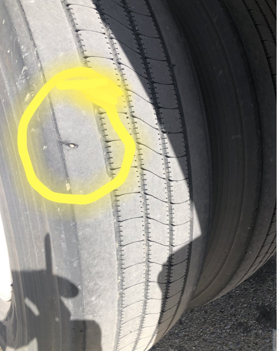

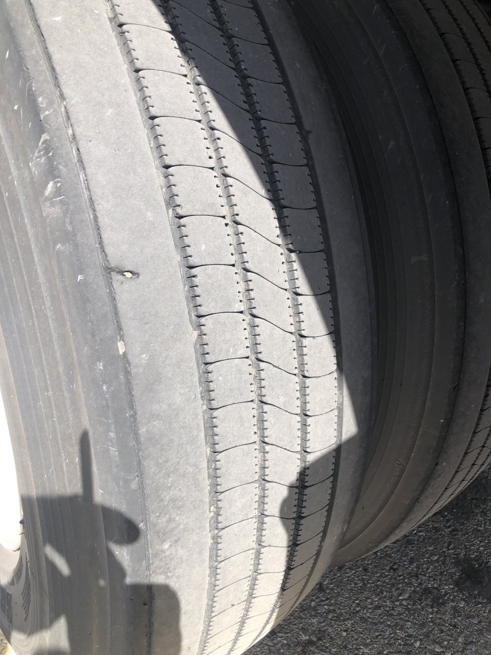

    pic is one of them with 300k miles already.
    Sadly buying a full set will cost. For me it’s about 10% IMG_4891.jpeg IMG_4892.jpeg of the cost of a new trailer for me. My attitude is once they all need to be replaced it’s time to trade it in.. Tires, brakes and every nickel and dime stuff is just throwing money away..imo.

    Looks like a nail or screw in there, mister.
    JB7, Sons Hero, Numb and 1 other person Thank this.

    Lol, yah it’s been in there for awhile now along with another. Going to get as many miles on them as I can until they start leaking and causing problems..

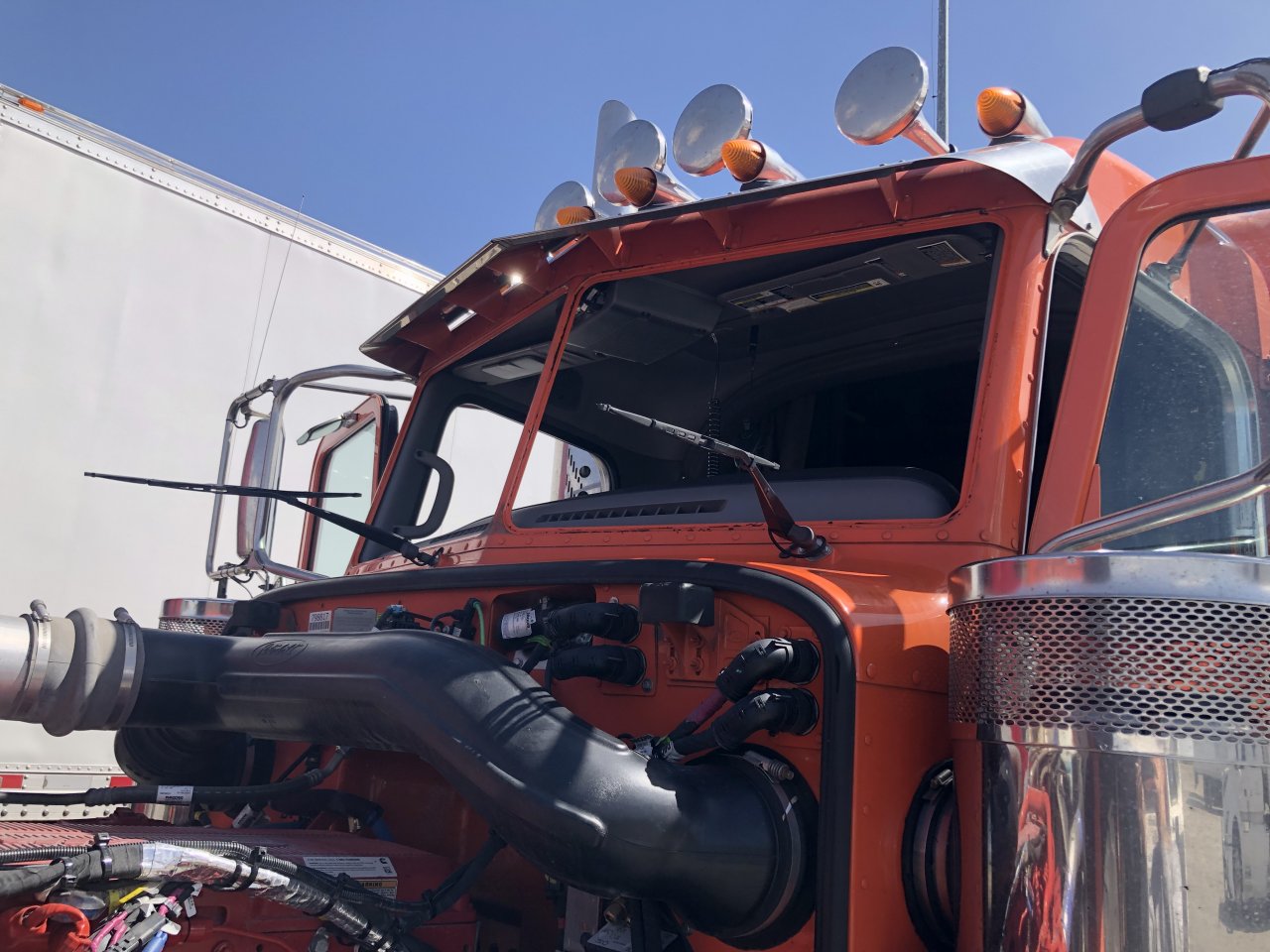

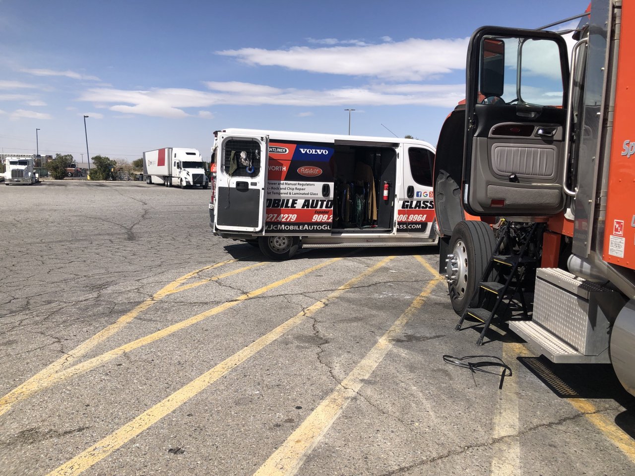

    Meanwhile I’m spending money on two new windshields that I really didn’t need. Just sandblasted and a couple small chips.
    Dude was parked in front of my truck today so I put him to work..that’ll teach him :) IMG_4893.jpeg IMG_4894.jpeg
