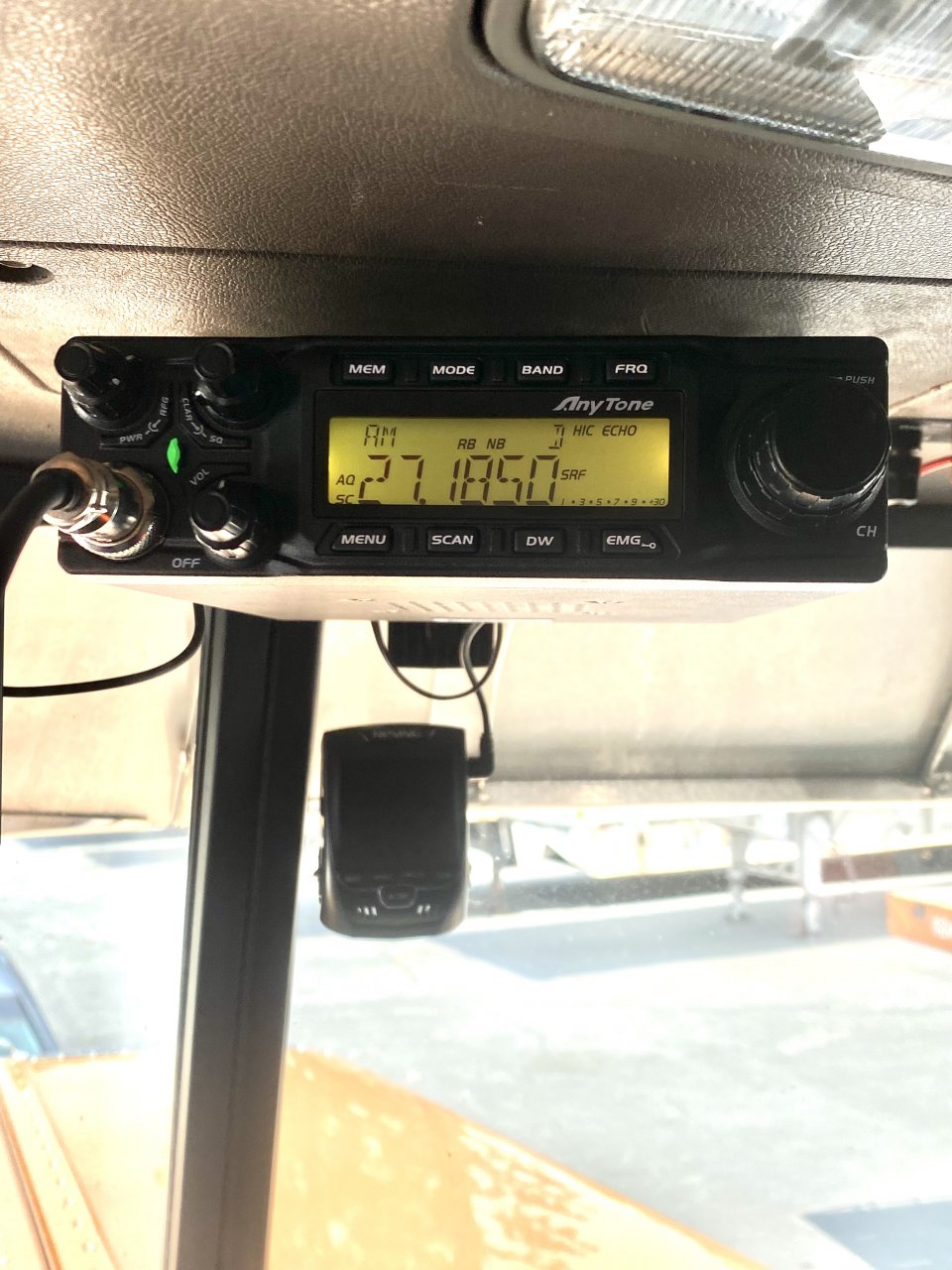

    Update on the ARES II:
    Let me preface this by saying that this is not a hobby of mine, but I have been using CBs since the 70s. That said, some of the features on this radio are new to me. There are a lot of things I don't understand like using channel 19 on FM, but I find the radio easy to use and adjust, and it is a defintite improvement over the standard 4 watt cb. When I installed the radio I checked the SWR with an external meter. The meter in the radio appears to be accurate. I really like that it displays SWR during transmit. I did find that while the SWR was near perfect on low power setting, it would get worse as power was increased, though still acceptable. It displays 1.1 on low power and up to 1.5 on high power. I imagine most of your understand why this occurs, but having no prior experience with a radio in which the power can be adjusted, this was new to me.
    The only thing I don't care for is the mic with the up/down buttons, as I would inadvertently hit them while running dowm the road and find myself a channel off frequently. Also, according to my son who I was running with, there is a lot of background noise (we run old trucks that are not the quietest). The sound quality is good when we weren't running down the road. I am going to purchase a noise canceling mic and try that. I believe that I will need to change the mic setting in the radio from electric mic to dynamic?

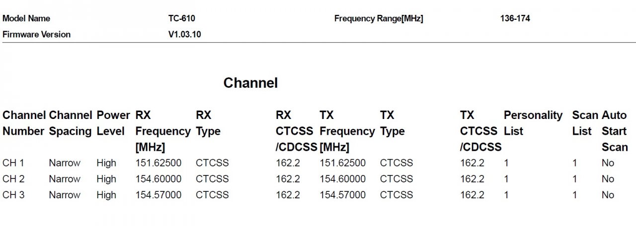

    136.8250 is aircraft I believe, So I doubt your company is running that for a company channel.

    I went back to look - you are correct. Here is what we use:

    standard vhf channels with tone coded squelch (private line in the Motorola world) any of the chinese vhf vhf/uhf will handle it, but probably not the low band (CB 11 meter) radios.
